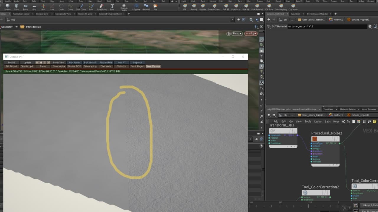

Octane disables bump effect at a certain distance from the origin, approximately 1500 units. Is it possible to keep the bump on the whole geometry instead without being tied up to the distance from the origin?

Have you tried to adjust the ray epsilon parameter in the kernel node?

yes unfortunately it didn't help this time

If you can share the scene, or an .orbx file exported from it or from the IPR window, I could report this issue to the core devs to check if something can be done to fix it.

here is the file
procedural bump issue.rar
