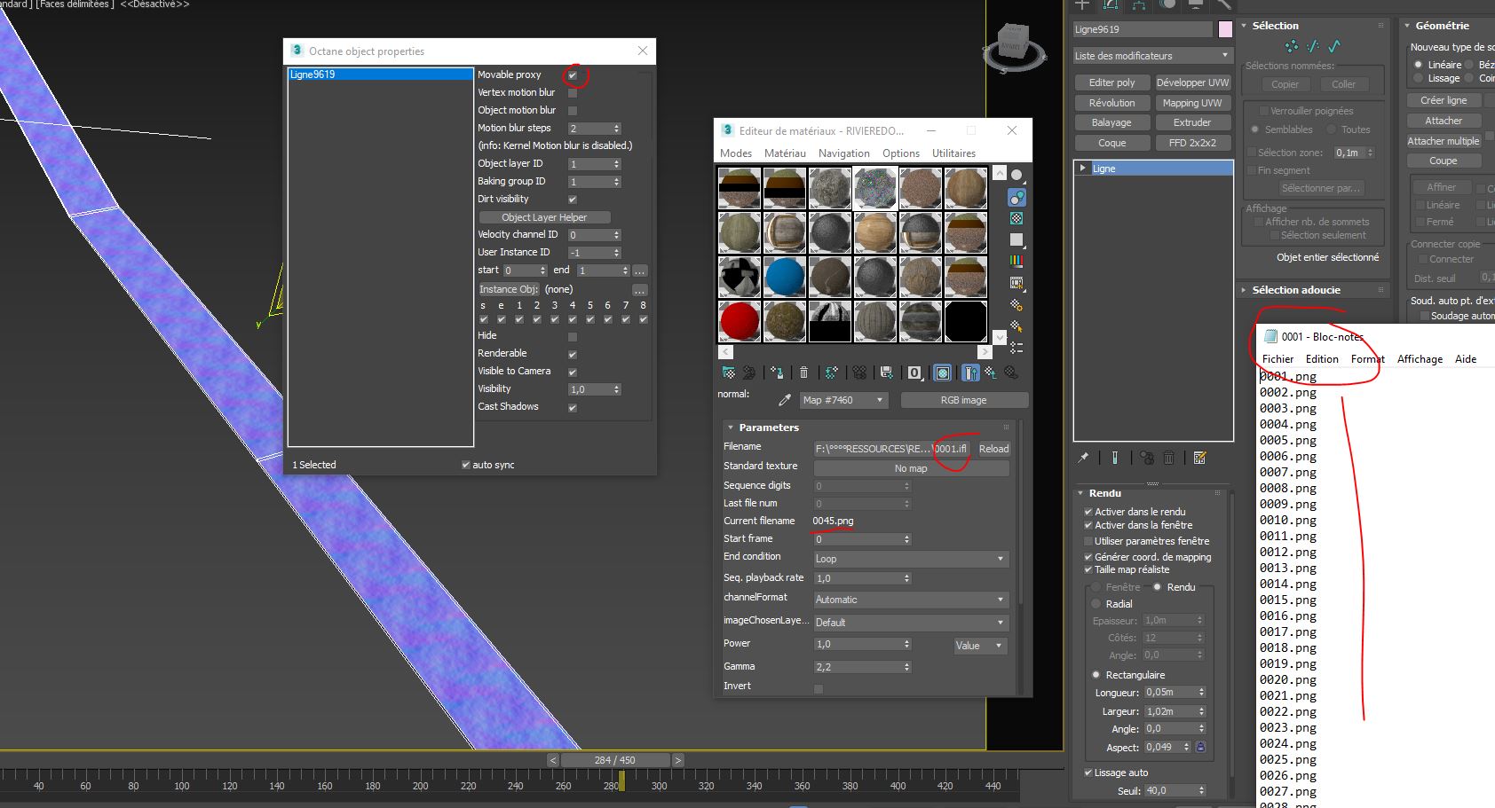

I have a problem with the IFL files
I know how to create an IFL file in a texture but ..
when rendering the animation is not done
when I move my time line, I can see the "current filemane" change but nothing changes in the view port or in the rendering window

in attachement a light scene

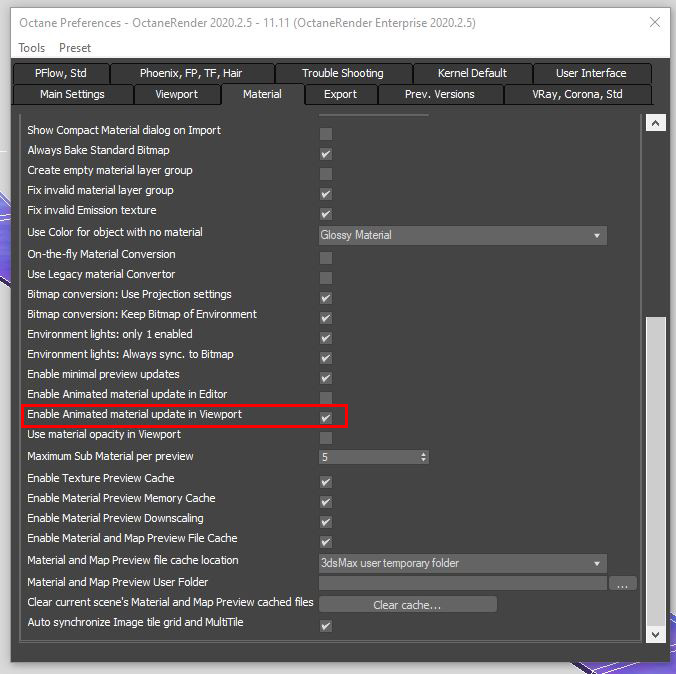

Your file works fine here :-)
I don't know for the other problem, but to see animated maps in viewport you need to check a pref (see pict )

OHH Nice, it works fine
thanks
