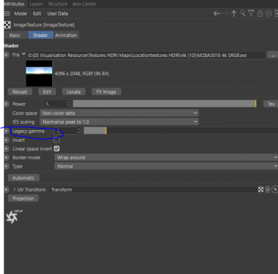

Hi, I've tried tweaking the gamma in the environment tag but nothing seems to happen? Just wondering if this is a bug?
I was able to do this in a older version.

The legacy gamma is only used when the color space is set to "Linear sRGB + legacy gamma". In that screenshot the color space is set to "Non-color data", so no color processing is applied to the image.
