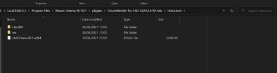

The installation path must be like this:
