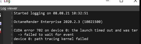

OR starts to render and suddenly stops, render time keeps going but seems like OR stops pushing in samples... Then C4D Crashes! Freezes completely!

Does this happen when you select just one single GPU at a time?
Also does this happen with an empty scene containing just a default render target? Otherwise could you share a simple ORBX scene you can use to reproduce the issue on your side?

another idea (sorry that previous pointers did not help to solve Your issues faster), what is Your system like. That might sound strange, but could You try to take out older card from Your system and leave only 1080tis? (just something to try if You are out of options)
