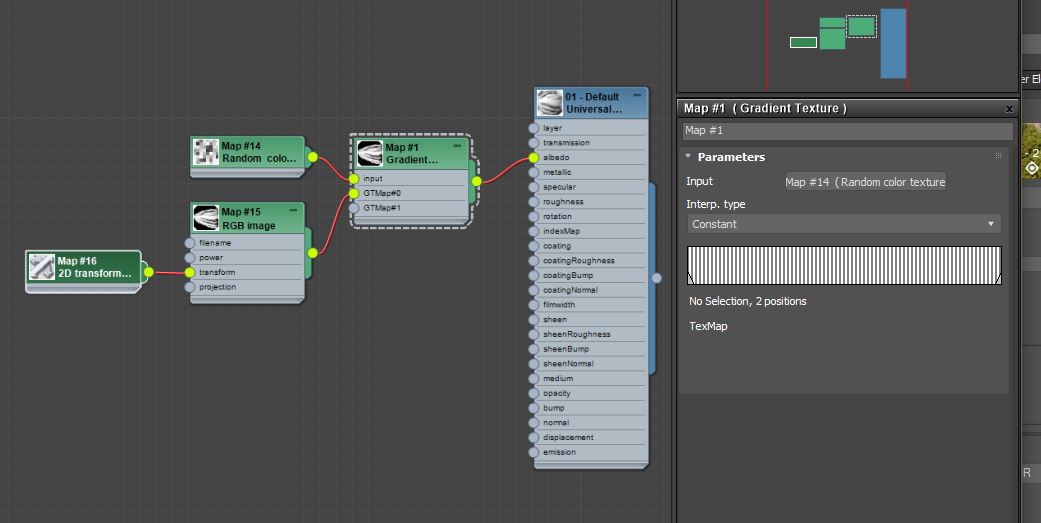

I set it up like the attached image. Is this right? I want the rotation and position to be sort of randomized.

for rotation and transform plugg the texture to an UVW transform node and plugg it to the gradient next slot and redo for more randomness...
Sorry I'm not in front of screen, I will post an example , but it will after summer break.

Here is an example of how to randomize textures and rotation over clone scatter.
you can use the same method by adding translation and / or scale values in the values of the UVW-Transform node, and also add or remove transformation steps by changing the number of variations of the gradient.
I attach the Orbx file in case
