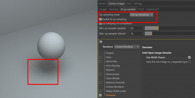

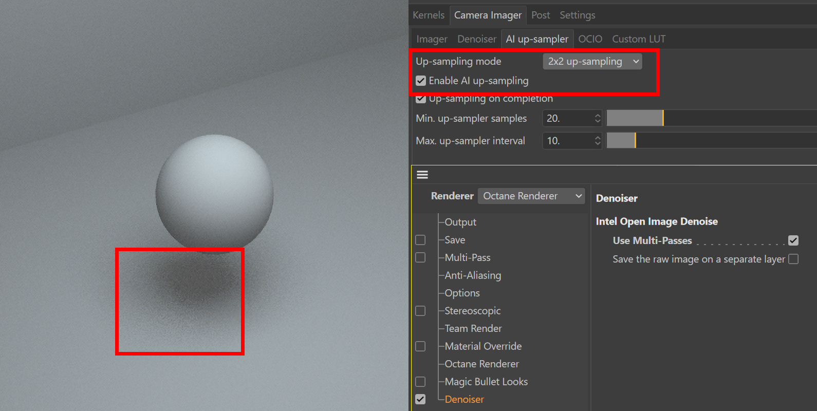

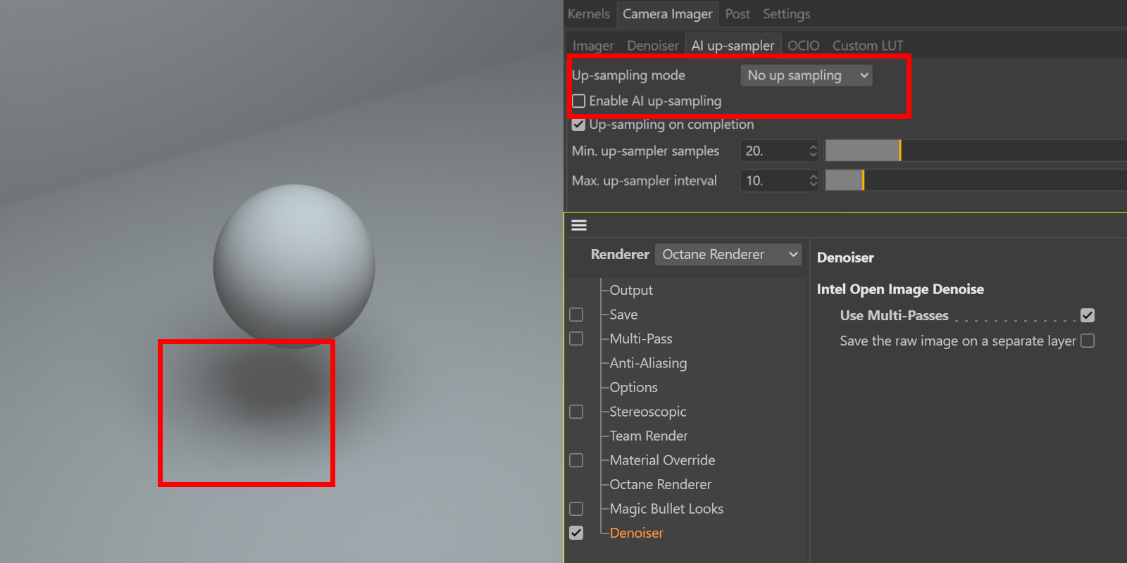

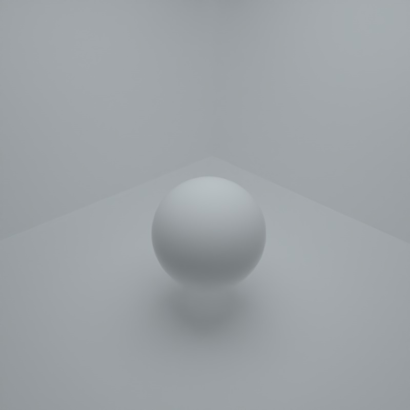

After 3 hours of struggling here is the result
1) if scene is rendered with AI Up-Sampler C4D native denoiser is processed but not effects on final image result
2) if AI up-sampling checkbox is unchecked, same problem occurs. Up-sampling mode has to be "no up sampling" as well.
3) mainly if Up-sampling mode is "no up sampling", denoiser is being processed and effects final image.
C4D 23.110
Octane 2020.2.4-R2
ACES workflow
test.zip
test scene
(87.43 KiB) Downloaded 187 times

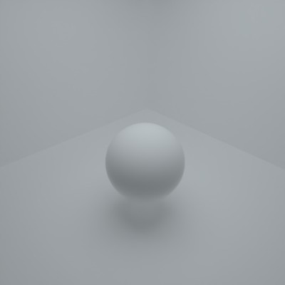

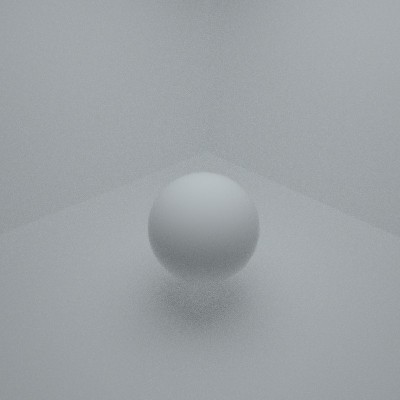

with Up-sampling mode was "2x2 up-sampling" + C4D Denoiser
with Up-sampling mode was "No up sampling"  + C4D Denoiser

hi again,sorry for my repetitive posts but I have to render my scene and with AI sampler I save 3 minutes for a single frame. As mention before I've tried to make render with high samples + Octane Denoiser solution rather than Intel denoiser but I couldnt get good result sadly.
So I have to solve this problem. Why if I use AI Sampler C4D denoiser does not effect output file? It runs but saved image is not denoised.
is there anyone who experience this? or is there any idea?

Denoiser modules require some extra data, not just rgb pixels. There's not any communication to C4D denoiser. That's probably the why you don't see any expected results.

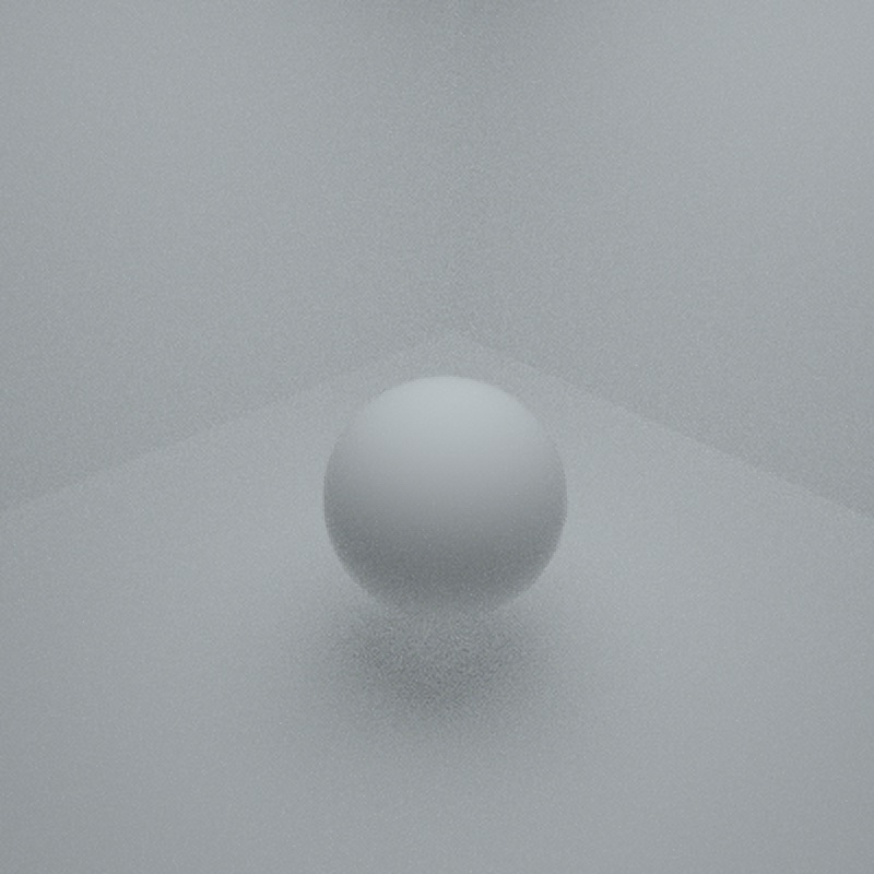

Without AI up sampling c4d denoiser works if it is used, doesn't. So in this case if AI-Up Sampling is used those data can't be used by c4d denoiser? and I assume that there is no cure for that did I understand correctly?
Delizade
Posts: 182
Joined: Thu Oct 18, 2018 10:38 pm
Location: Istanbul
without AI-UpS + C4D Denoiser.
AI_upsampler&c4dDenoiserIssue.zip
test scene
(9.5 MiB) Downloaded 214 times
latest test files are attached
