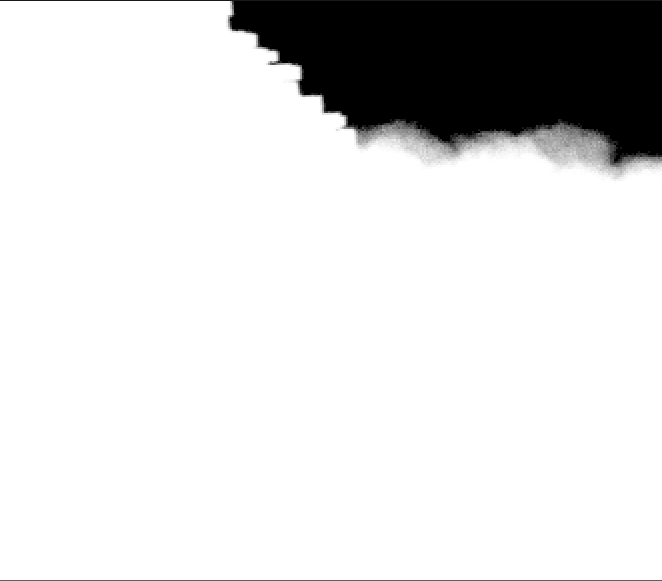

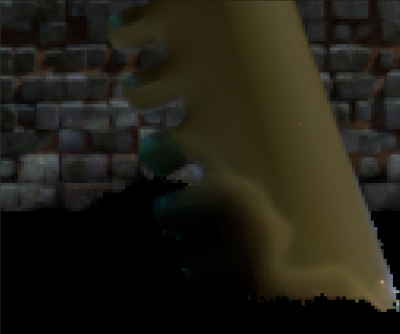

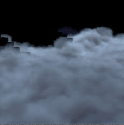

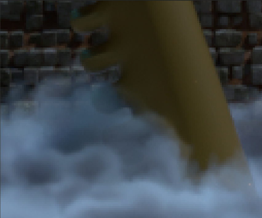

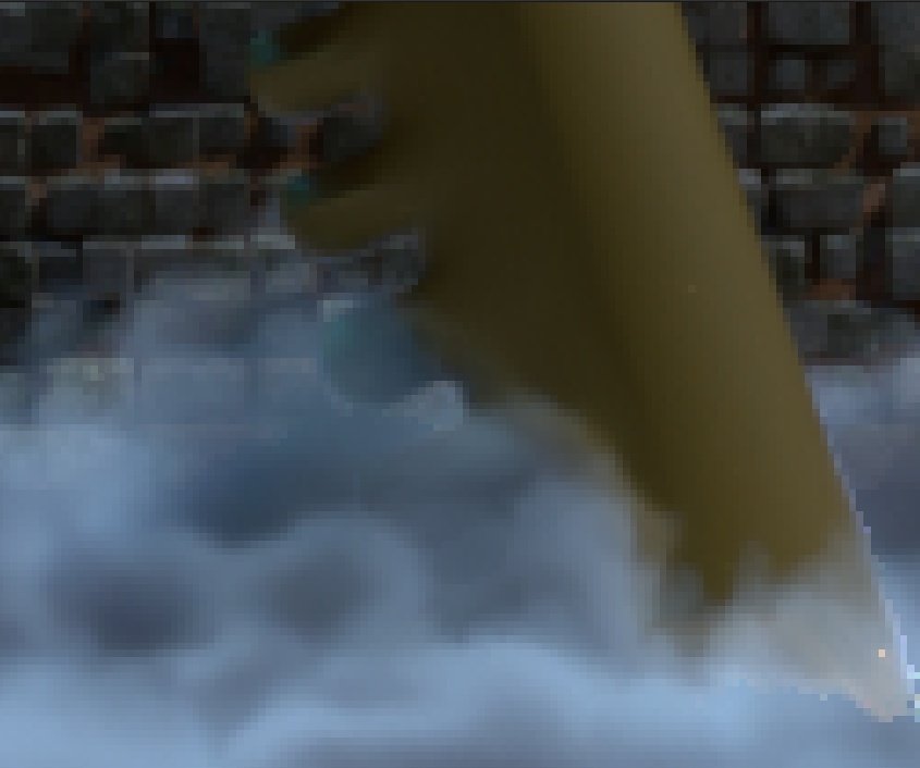

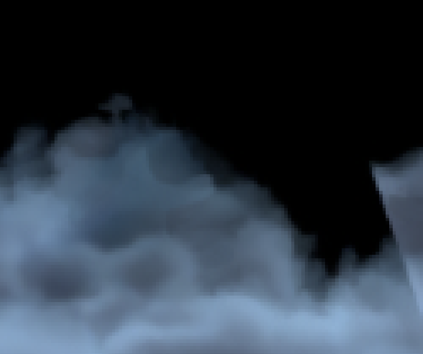

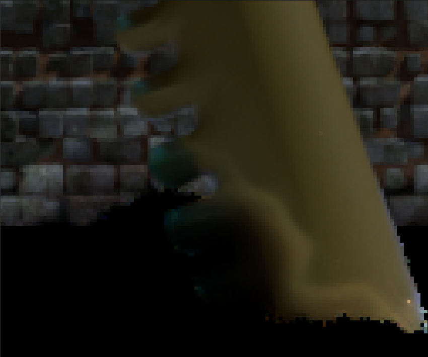

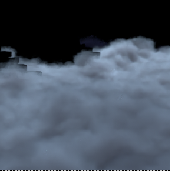

I'm trying to do multipass rendering with octane, and I'm exporting the Denoised passes with 32 exr to Nuke. I'm trying to adding up the passes, but they just not add up. Especially the denoised volume pass. (DenoisedSumWithVolume image)
Am I missing something, or this is not working properly?

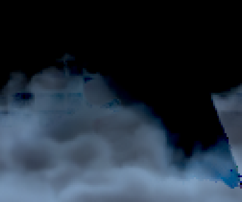

I attached the denoisedBeauty (for comparation). I add togather the other denoised passes (merge over), but in the end, if I add the denoised volume, it will differ from the beauty. I attached an image of the Beauty minus the previous sum, and the differerence is visible comapred to the denoised volume.

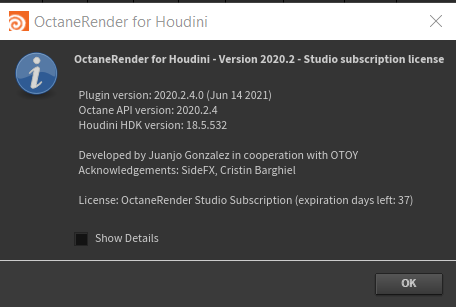

This is my current config:
Plugin: 2020.2.4
API: 2020.2.4
Houdini HDK version: 18.5.532

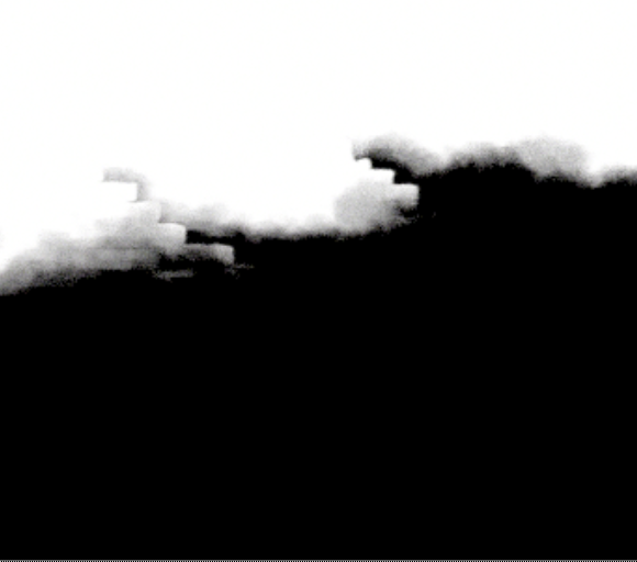

So what happened, is that the denoised volume pass had an alpha, and I thought (becasue in houdini, under the passes subgroup they were grouped togather), there were all the denoised passes, I thought that if I just merge/plus everything togather in Nuke, I should have a correct result. (only denoised)
But I realised, that the denoised volume's alpha is bad (or if it is not bad, I don't know why it contains the other background geometries alpha), and under the non denoised passes, there is the volume mask option, and using it as a mask for the merge, and then plus it, I got a correct result.
