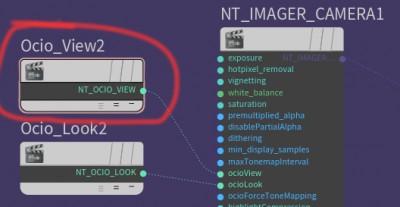

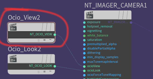

Hey, I've noticed some minor quirks that I'd let you know about in case you are not aware:
- The OCIO View / Look has no entries on the new RenderTarget, I have to open the node and place one down manually to get any options.
- The sliders for upscaling don't grey out like they used to when upscaling is disabled. Upsacling / denoising also seem to be enabled by default, which may or may not be intended
I can't get options on this unless I replace the one in the rendertarget
These are the ones that I must replace to get an OCIO View working
But I am very excited to have these options on the node as before they were missing and I had to add the node every time anyway! :D
Thanks for your work, I will keep testing :D

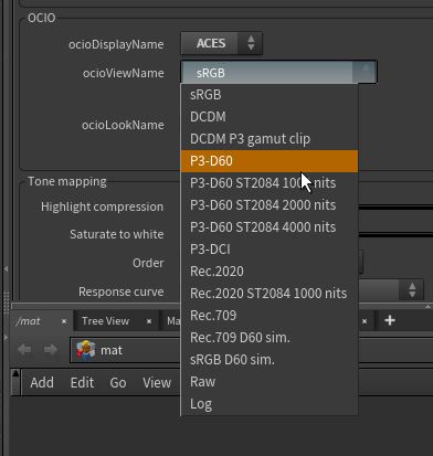

Sportler wrote: - The OCIO View / Look has no entries on the new RenderTarget, I have to open the node and place one down manually to get any options.
Hmm, weird! Here it seems to work fine. I have a standard OCIO = "E:\OpenColorIO-Configs-master\aces_1.0.3\config.ocio" config in the env file and as soon as I add the render target, the OCIO display name is there, and once I select it, the OCIO views for this display is available. You need to select a OCIO display to populate the views menu ... perhaps this is the problem.

Ah, you're correct! It does actually work, but you have to check the ocioUseViewLook checkbox to get any entries in the dropdown menu:
I think that the drop down should be disabled if you have not checked the button to make it less confusing :D

Sportler wrote:Ah, you're correct! It does actually work, but you have to check the ocioUseViewLook checkbox to get any entries in the dropdown menu:
Selecting the OCIO display name should be enough for populate the ocio views. I know that it is weird to select the OCIO display when you want to have it with its default value, already selected, but it is the only way that I've found to dynamically populate the views menu in the HDA.
