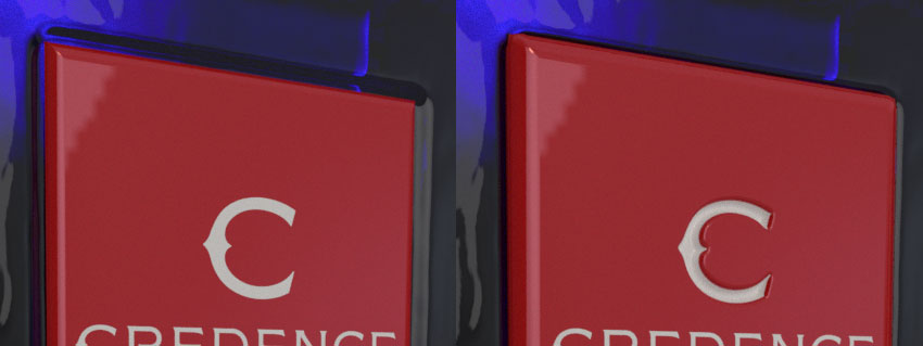

I have modelled a panel on the front of bottle, the panel has a debossed area with a letter C. I have applied a composite material to the panel with a red base material, a white material, and a black and white image for displacement.
The displacement is affecting the whole panel instead of just the area of the 'C'. How do I fix this? I know I've seen this problem before...
The panel is an SDS surface with plenty subdivisions, the displacement file is 16bit, UVW projection etc.
Posts: 10533
if you are using Texture Displacement, you need to use a polygon selection to restrict the displacement where needed.
If you are using Vertex Displacement, you can use the Border Mode in the ImageTexture node, to remove the displacement tiling.
