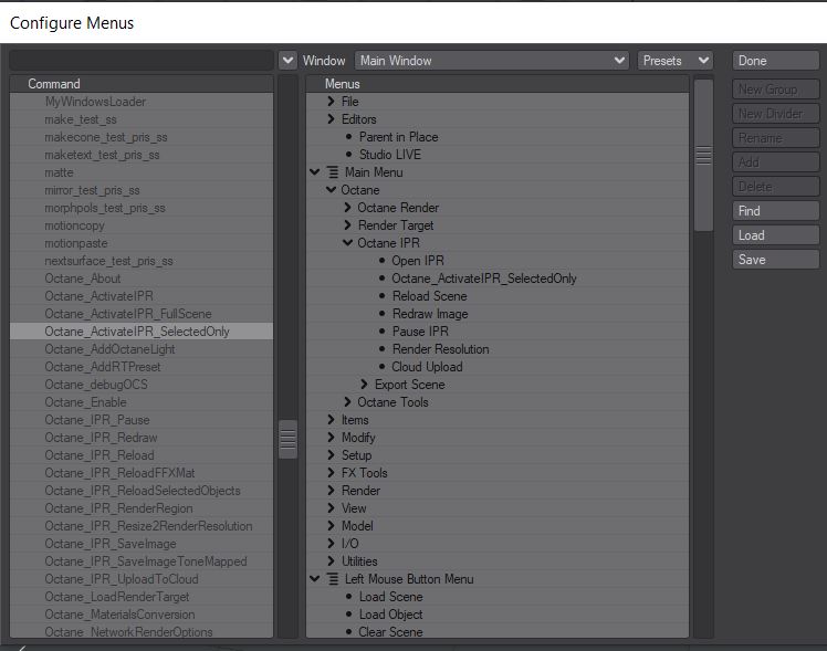

The "Octane_ActivateIPR_SelectedOnly" opens the IPR rendering the selected objects only. You need to map this command to the menu if you want to have it ready to use.

Either I have not seen this until now, or I believed that it refers to some internal processes.
Thank you.
