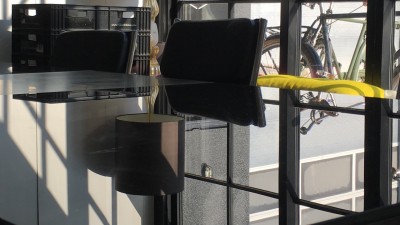

Let's say I have a image plate of a very reflective surface:

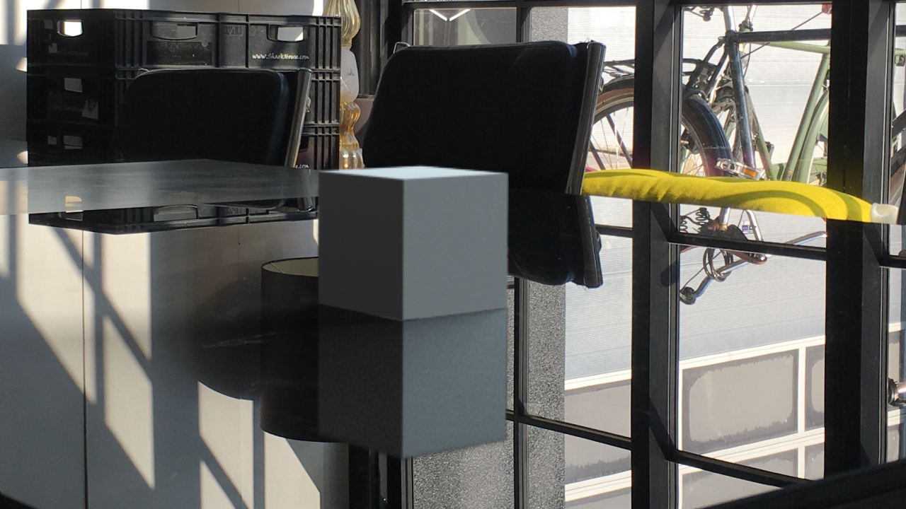

And I want to composite this awesome 3d cube into it. Turn on Render Layers, Reflections, composite the reflection pass in using "Add" and oh no..

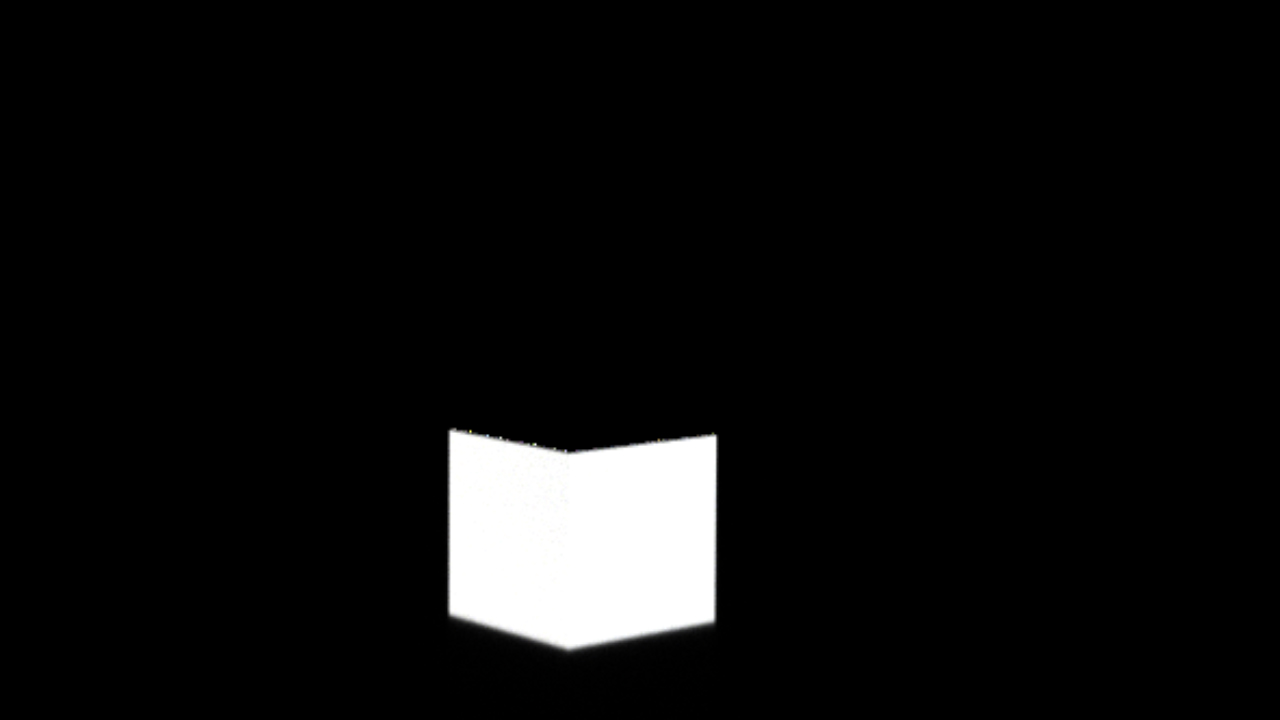

It's all transparent, which is definitely not what I want. So, at this point.. what does everyone else do? Is there some secret pass I'm missing here? My only workaround is to do a second render with a white material on my cube, and a Texture Environment cranked up way up so the object gets completely white, so I get a luma mask I can use for compositing the reflection:

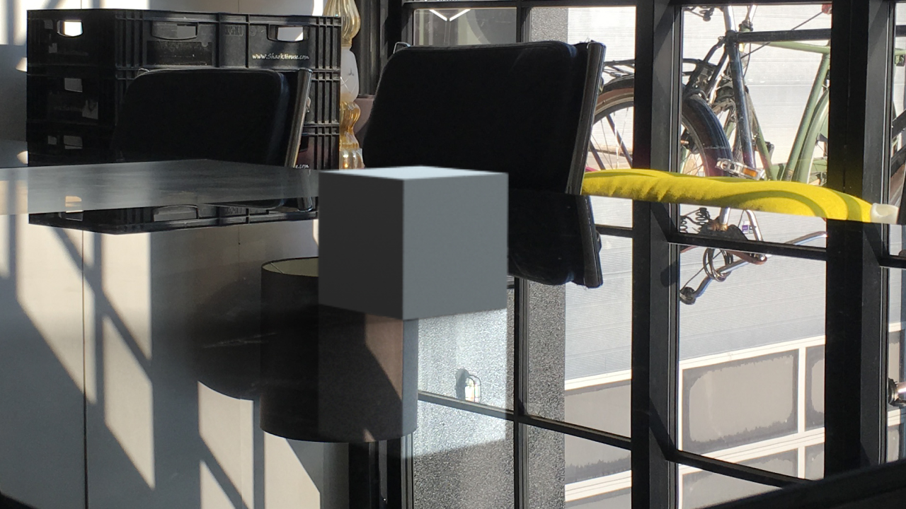

That mask I can use to block out the reflective surface before adding my reflection pass onto it. Like this!
I mean.. I'll just continue to use this workaround for these compositing jobs, but it's a bummer that some sort of mask or alpha channel isn't built into the reflection pass. Has anyone found any better workarounds or.. better yet, is there actually a pass that gives me the mask I need?
