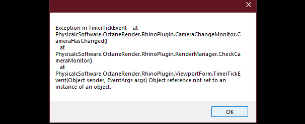

Although I am getting this pop up when I try to close one previously created scene and load another one also with the odd crash. This seems to flash quickly.

Regarding the TimerTickEvent error, is it only happening for one scene, or all? Have you tried deleting your config.xml file? There is also a newer version at viewtopic.php?f=41&t=77787 which may resolve this issue.
