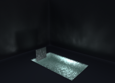

Hi guys,
i cant manage to ge5t caustics in this scene.
On the right you see setting for water - a simple displaced plane - and light - a geometry light under water.
I tried anything:
- using a smaller light and moving it in order to concentrate rays.
- Using PMC instead of PT and tweaking settings. Caustic blur is  0% and GI clamp in 10000.
- giving water a thickness.
- enabling/disabling fake shadow
- Exaggerating displacement in order to get a more visible effect
But nothing worked, no caustics.
I would expect to have all the walls around washed by caustics like in this example:
thanks in advance
Paolo

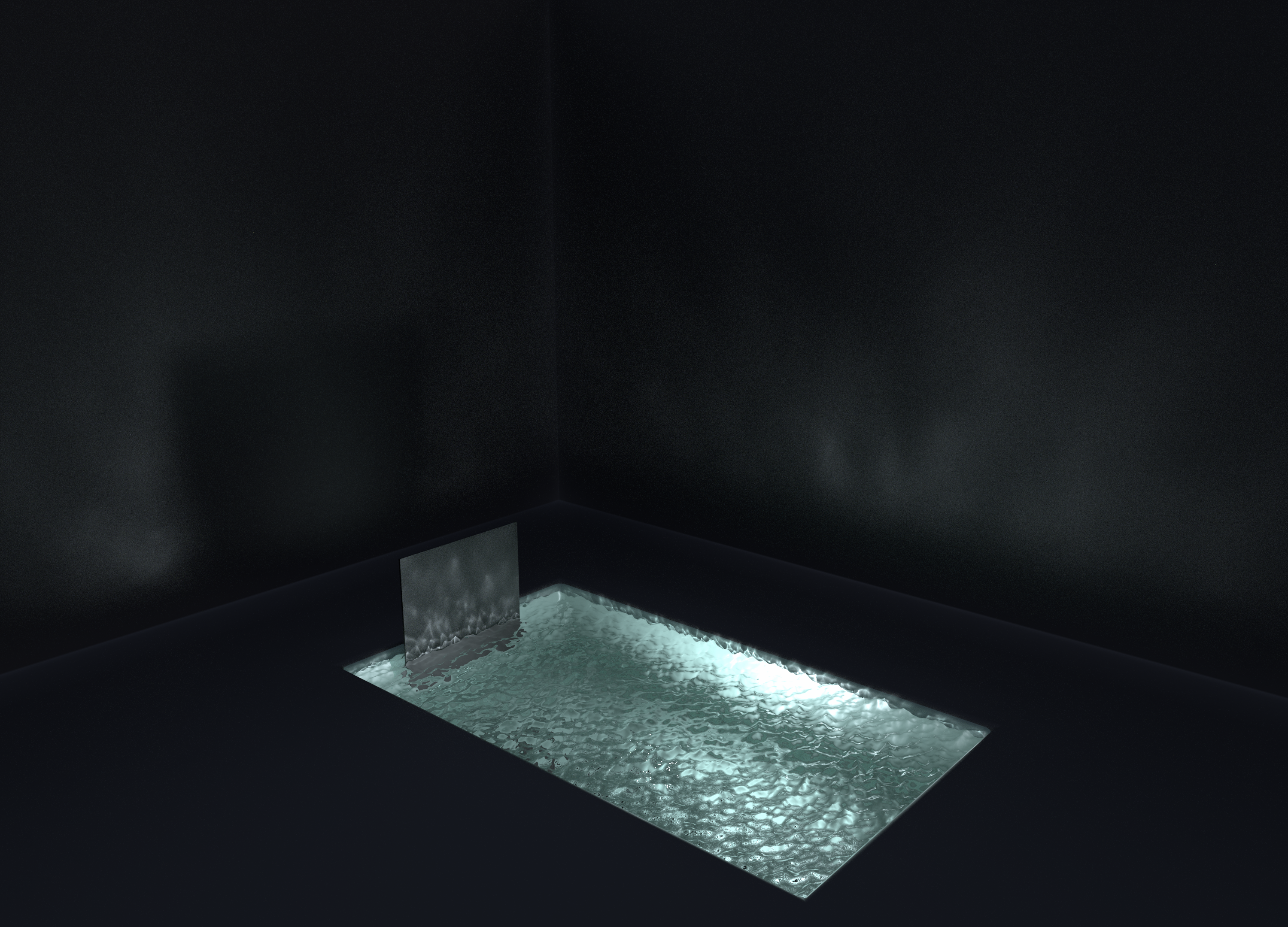

Octane

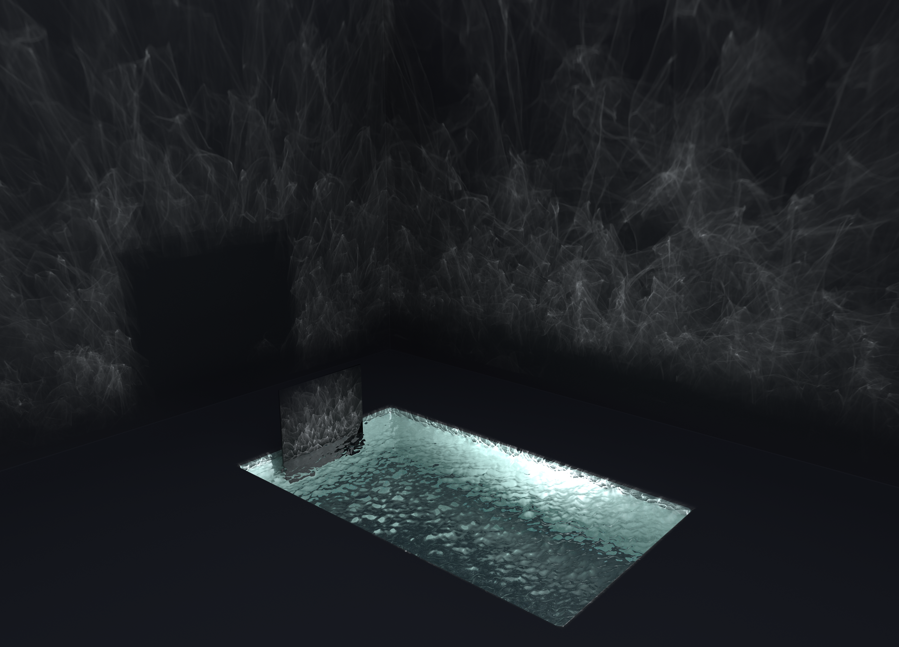

Luxcore

Octane
Luxcore
