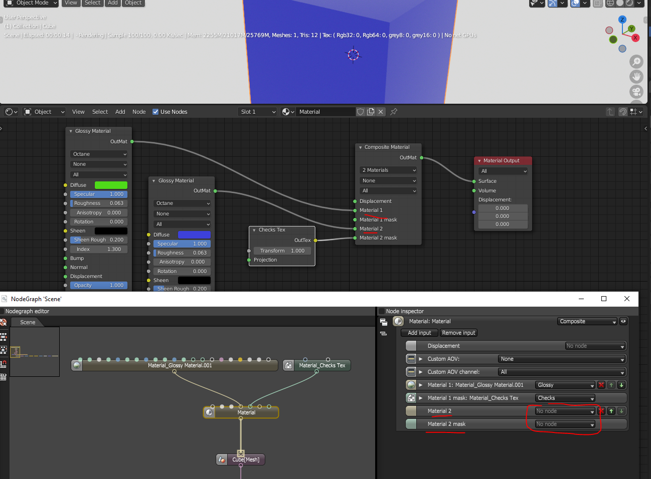

Downloaded the update yesterday and been trying to solve this. Updated drivers and reinstalled as well.
With a Composite material the Material slot 1 isn't working.
Shader updates correctly when slot 2 is used.
more screenshots here
https://imgur.com/gallery/lROyGzm

He's not using "material 1 mask" though. He's using "material 2 mask". This is working in 2021.1 XB2 standalone.
EDIT: It also works in the 2020.2.4 (23.10) release. I dont have 24.0 installed to check at the moment.

I installed 24.0 and it fails to work there, so it looks like a bug in the 24.0 build. You can see the nodegraph in this screenshot is not creating the material correctly.
Its plugging material 2 + mask into material 1 + mask
I have attached a blend file
composite_mat_001.blend
(842.4 KiB) Downloaded 143 times

Oh, I was testing it in 24.10 where it works correctly.
I'll ask to fix the current 24.0 version.
