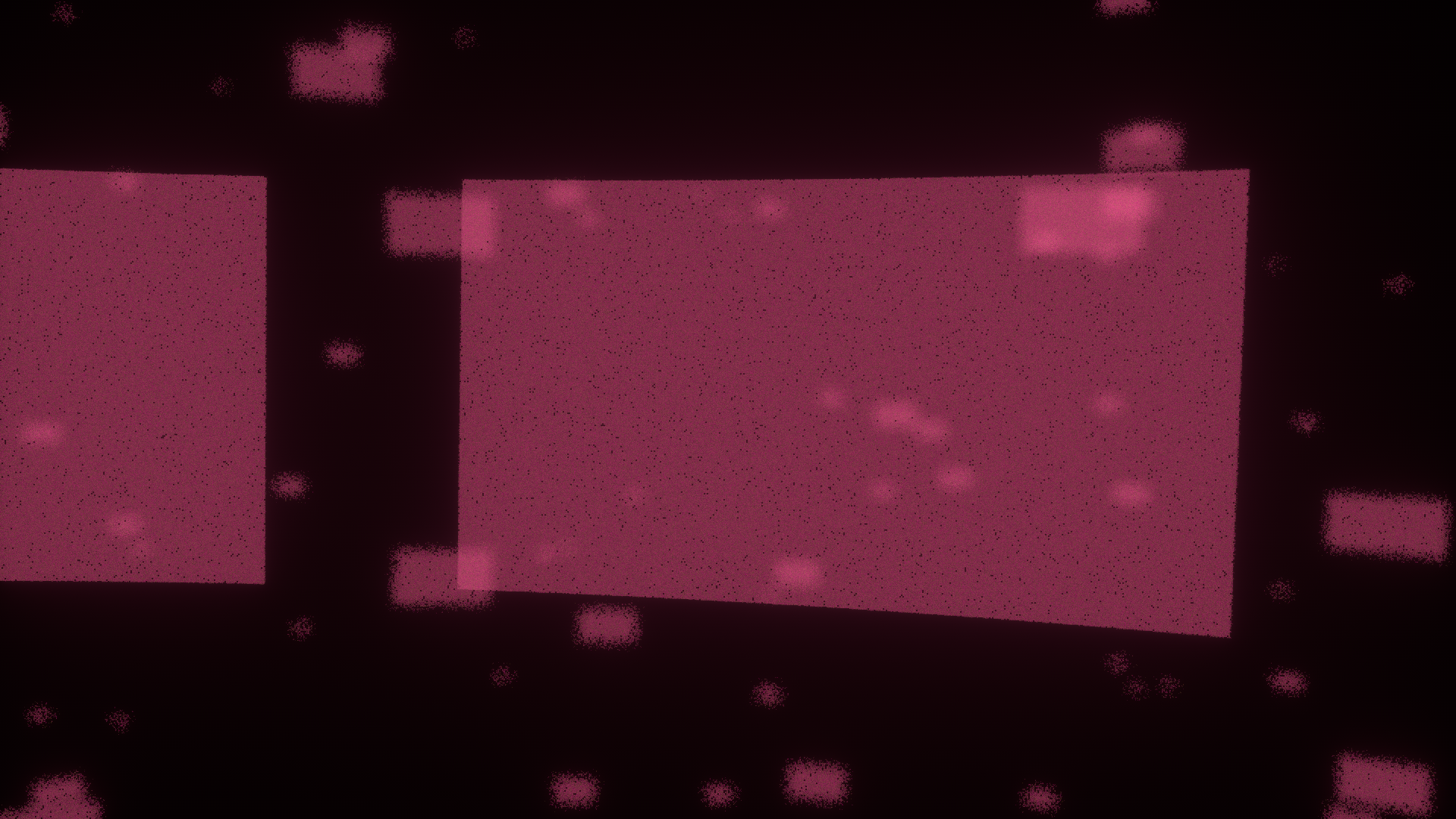

I'm trying to reduce render times with the Adaptive Sampler, but not getting many positive results
I have a bunch of semi-opaque emissive planes, with a lot of motion blur and depth of field turned on. There are no lights or HDRIs in the scene.
Here is a 512 samples render which took 15 secs:
Here is the same render with adaptive sampling turned on (128 min samples):
It knocks off 1 seconds, but the quality isn't great. I tried to reduce further the min samples but that left black spots and didn't help render time:
Any ideas how I can use Adaptive Sampling properly on this? Or perhaps I'm thinking this project isn't suitable for AS.

Try watching the Noise channel as your frame renders. I'm looking at one of your images in photoshop with the levels cranked up, and I can see that there are glow or blur gradients covering pretty much every pixel in the image, even though it looks like there are large areas of simple blackness. If those areas really were just black, you would probably see a significant reduction in render time with adaptive sampling. To reduce your render times, you're probably going to need to increase your noise threshold a bit, or reduce that glow/blur. When you watch the Noise channel, the areas that turn green have reached your threshold, and are no longer using up render horsepower.
Ah yes, sorry I forgot to mention that bloom on there.frankmci wrote:Try watching the Noise channel as your frame renders. I'm looking at one of your images in photoshop with the levels cranked up, and I can see that there are glow or blur gradients covering pretty much every pixel in the image, even though it looks like there are large areas of simple blackness. If those areas really were just black, you would probably see a significant reduction in render time with adaptive sampling. To reduce your render times, you're probably going to need to increase your noise threshold a bit, or reduce that glow/blur. When you watch the Noise channel, the areas that turn green have reached your threshold, and are no longer using up render horsepower.
That makes sense, I understand a bit more now. It's like saving a gif, you'll get better results with flatter colours.
Thanks for your help!
