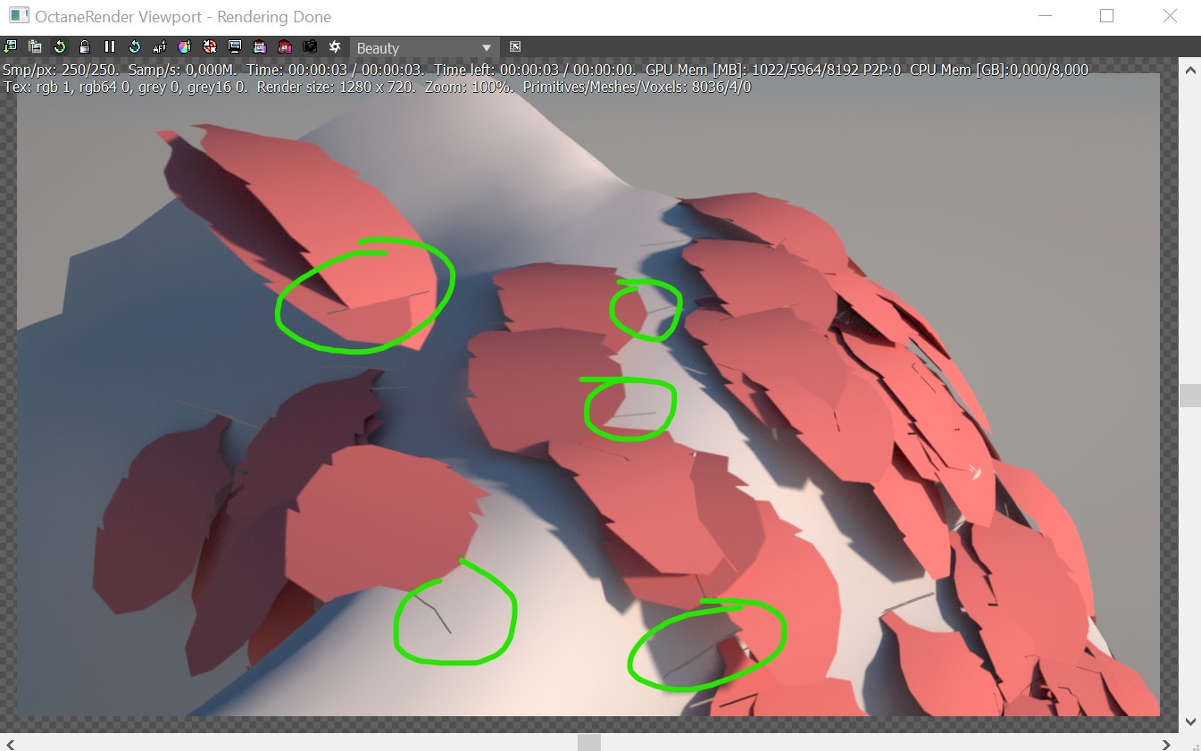

here again with this bug that seems silly but it's not...
it seems it's something related to the alpha shadow calculation as it's not well calculated when there are intersectios.
I will share the scene in next post.

here previous max scene...
hope you can find a solution... as for a bird or grass or whaterver where you use opacity maps... this is needed to be rendered properly where the geo intersects (but the alpha channel not)...
thanks
thanks

Hi javierluisbravo,
in this case try to set the Ray epsilon (Kernel Panel) to 0,000001
Regards
Paride
Regards
Paride

Thanks..
Octane does not allow me to put so many ceros there.. but i put it in 1.. and then i put in 0.. and it got fixed....
there's a bug in the spinner there... just to let you know.
thanks for the fix!
thanks for the fix!
