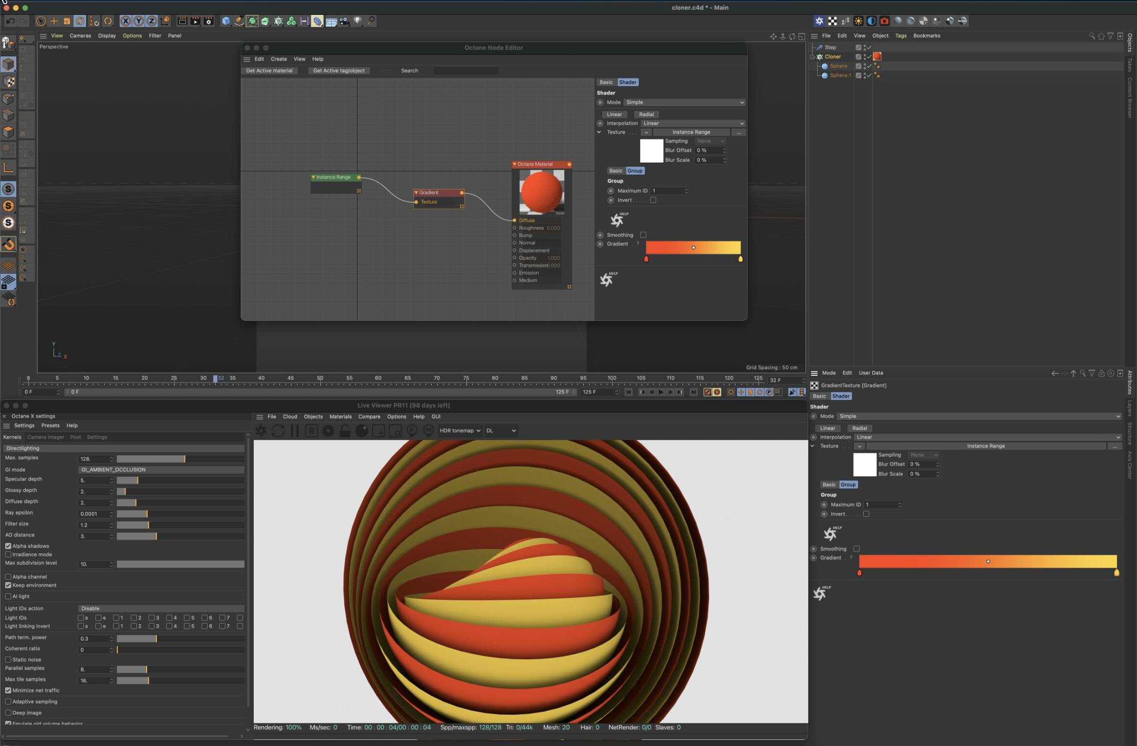

Posts: 10621
the Random Color node is not the correct one in this case.
You need to use an Instance Range node sets to 1:
I have used an Octane Gradient node to change the colors, but if you ned Black and White colors only, you can pipe the Instance Range node directly in the Diffuse pin of the material.
https://docs.otoy.com/cinema4d/InstanceRange.html
