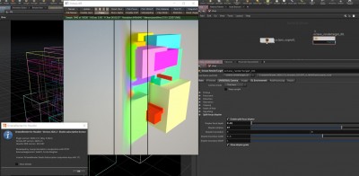

Hi Jaunjo, it's been a while since I've used the Split Focus Diopter feature on the universal thin lens camera. I noticed that rotations do not appear to have any effect on the image or the diopter guide. I remember it was working in much older builds. Here are my specs and an image to confirm what I am seeing.

Split Focus Diopter Rotation not working - 18.0.597

Hmm, there is a problem with this parameter. It seems a float number between -1.0 and 1.0 or something like that, but the slider is exposed as degrees. If you type a floating value, for example 0.2, it should work fine.

thank you for clarifying the value range for that parameter. I always assumed it was intended to be expressed as degrees of rotations. Using the range of -1 to 1 works! I'm going to make a note of this for future reference. It would also be helpful to mark this in the tooltip for the parameter.
