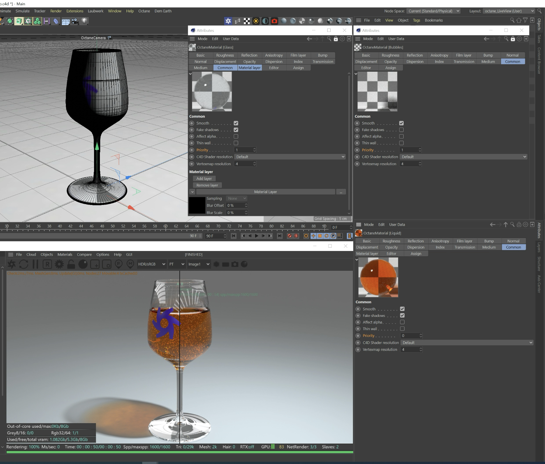

Here is a fast example of nested dielectric with different Specular priorities, and Material layer for the logo on the Glass:
ciao Beppe

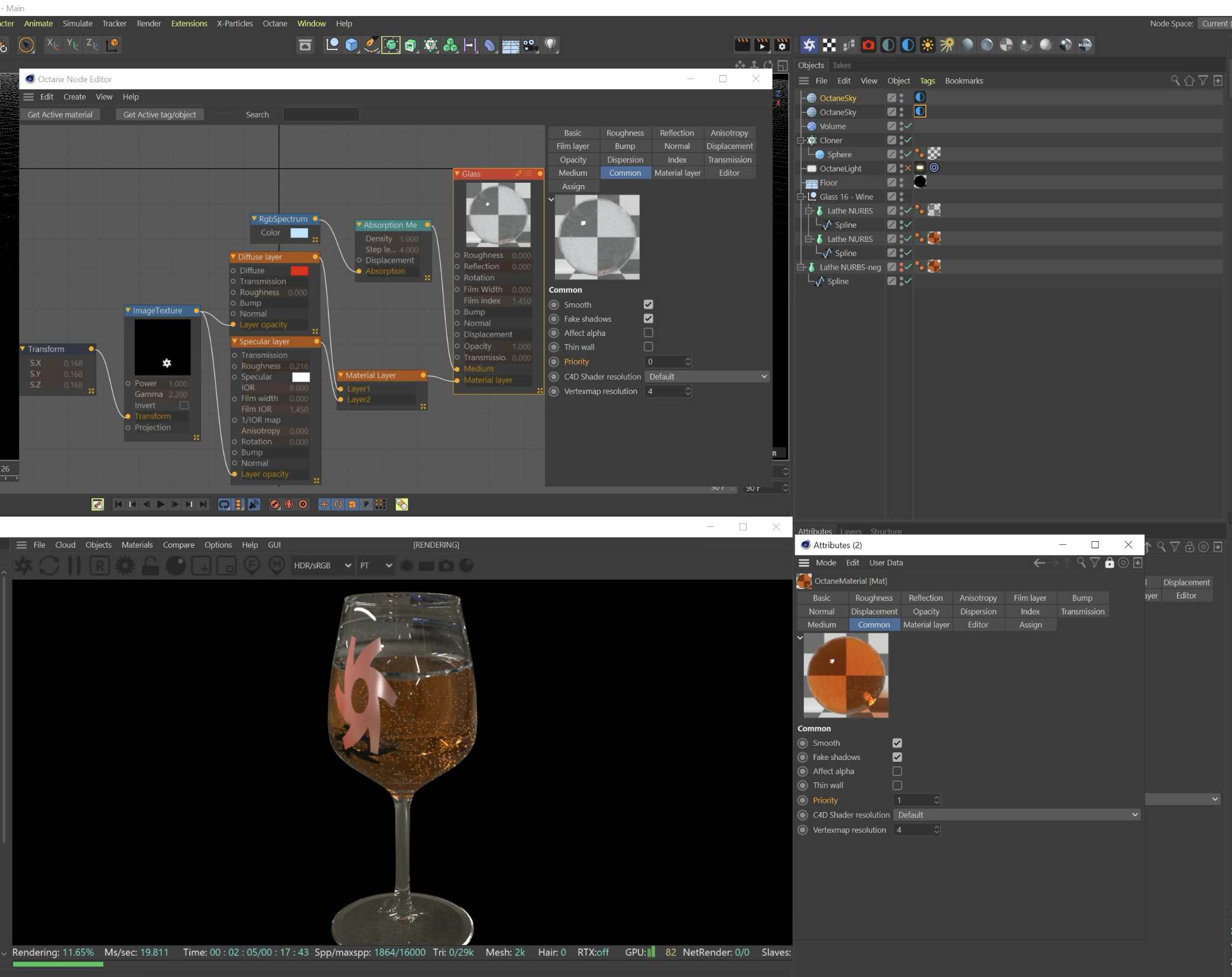

That's super interesting Beppe thx for the reply! I did try with Material layers but must have done something wrong. What's that end node? the glass? And how do you restrict the logo to the outside of the glass? Could you share that file?

Just noticing Beppe, that it looks like your example is producing an error. That dark refraction of the logo inside of the glass is exactly what goes wrong here - not supposed to look like that..

Sorry, my mistake.
With Nested Dielectric, the liquid must have a lower Priority. On the left, nested dielectric option active with lower priority for liquid, and on the right, with nested dielectric option disabled:
Here is the c4doctane R21 scene file:
NestedDielectricLogo.zip
(232.04 KiB) Downloaded 174 times
And here is the .orbx scene:
NestedDielectricLogo.orbx
(4.98 MiB) Downloaded 162 times
