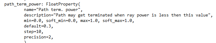

The octane nodes work this way because they have the wrong value type
They are floats as is
But blender uses sliders
It's just a ui thing
I have a customized version where I fixed many ui issues with octane
If they had a github where they would have it uploaded, one could make some pull requests
Can we get this fixed in the official build please?

Another user "Ed O'Connell" also posted this:
Theres a step and precision property on any input, this is what dictates the interval it jumps by when scrolling/ dragging
Would be easy an easy change

The material nodes are written in C++ so the Python solution is not suitable here. We'll look in some alternative solution.
