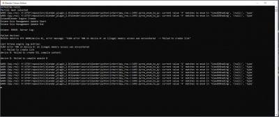

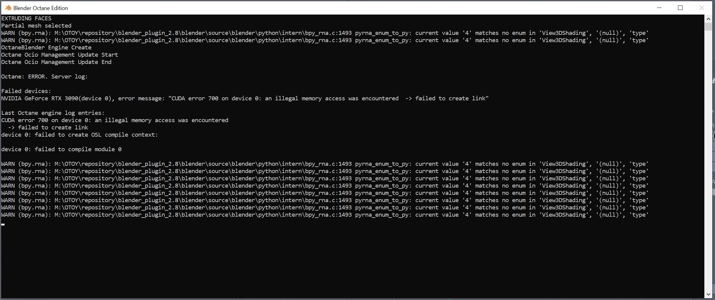

Once I open the console get this message:
Failed devices:
NVIDIA GeoForce RTX 3090(device 0), error message: "CUDA error 700 on device 0: an illigal memory access was encountered -> failed to create link"
