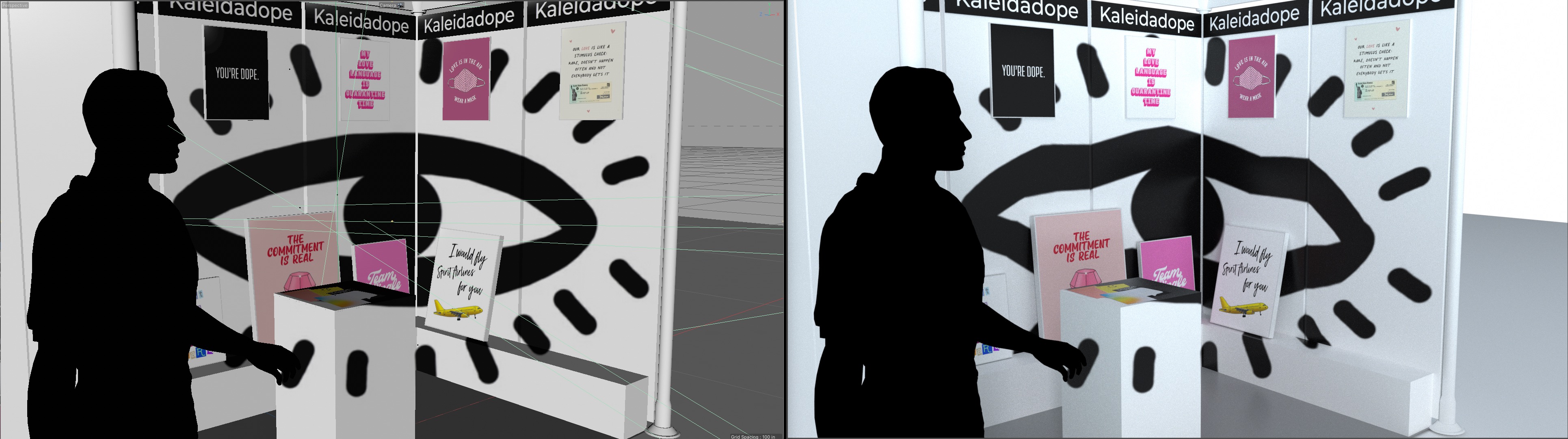

Any idea why my camera mapping texture is so screwed up?

You need more subdivisions for objects. It happens if you apply to a box with a few faces.

aoktar wrote:You need more subdivisions for objects. It happens if you apply to a box with a few faces.
Thank you!
