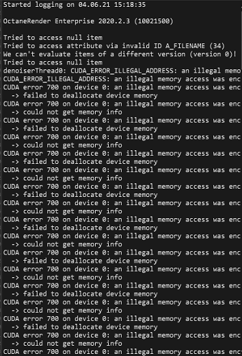

hello everyone
I'm getting this type of error, mainly with render farm. also with rt3090ti machine.
This kind of error doesn't happen often with previous version.
thanks
Giuseppe
Posts: 10533
CUDA error 700 is 99% related to incorrect or corrupted Nvidia driver.
My suggestion is to use DDU to completely remove any installed Nvidia driver, disable DCH, and perform a clean installation of latest Standard Studio Nvidia driver.
Also make sure to have updated Win 10 to 2004 or greater.
