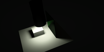

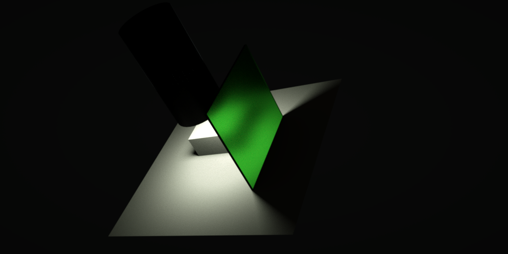

Three quick points on the attached pics:
1. I've been reading on the forums for a while before I bought, and playing with the demo. I could not get glass to be "rough" as in pic 3 below. Was that just taken out, or not available in the demo?
2. I do remember reading that the shadow problem in these pics (should be green light falling on the surface on the other side of the light) was a bug, and was "in the pipeline". Is that a fix for 2.3. or does that come later? A couple of projects will have to be deferred until that's worked out. All I'd like to know if that's in the fix queue for this next release or some time beyond it, thanks.
3. The pics attached don't demonstrate this, but I've had a couple cases where I've had to turn the blackbody or emmisive texture "power" all the way up -- think for a street light outside -- and at full power it wasn't bright enough. Is there guidance on how to adjust for that right now? A larger emitting mesh (more emitting surface) seems to help, but beyond that obvious one, anything else to apply?
