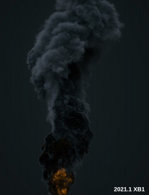

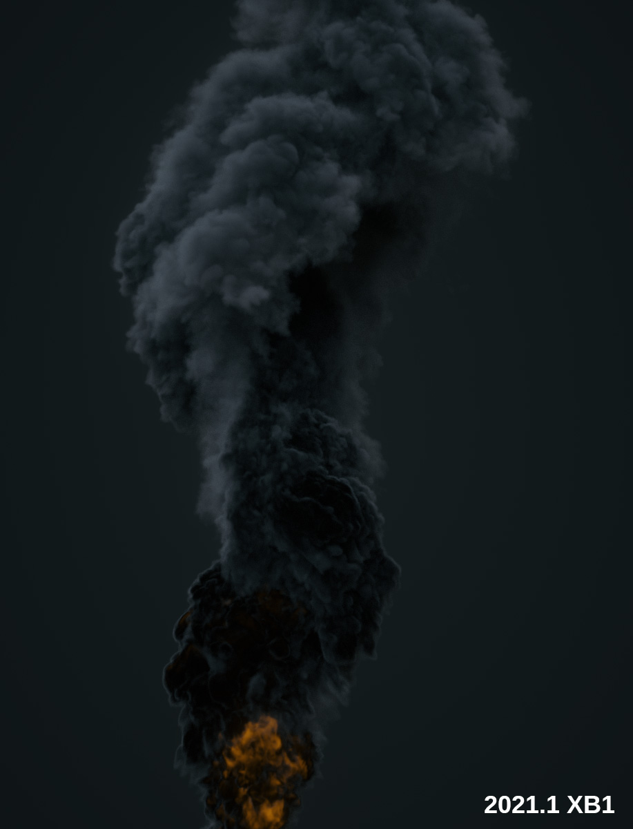

Hey Guys
Great release, but I have found a couple of issues.
Firstly, volumes are rendering very differently when compared to 2020.2.3 (see attached renders) no settings have been changed
Even if I remove volume gradients and emission, there's something not quite right...

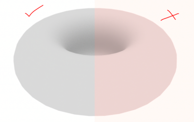

BUG: Denoised output has redish tint with kernel white light spectrum set to D65
1. Load the attached scene and render.
2. View the DeMain output
RESULT: DeMain has a redish tint
If you set kernel > white light spectrum to legacy, it renders correctly

funk wrote:BUG: Denoised output has redish tint with kernel white light spectrum set to D65
Thanks for the report; I'm looking into it.
Update: issue will be fixed in XB2.
