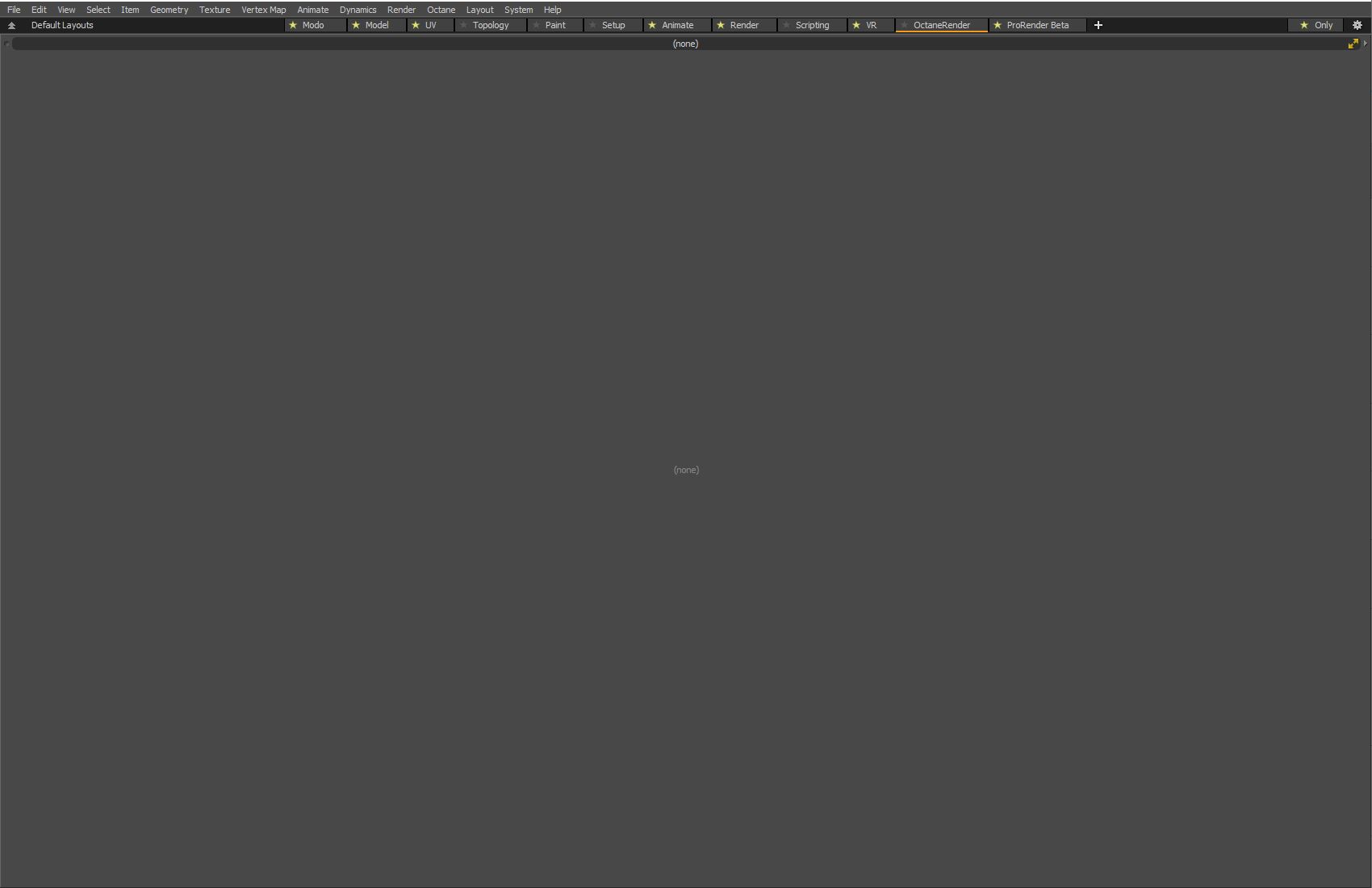

I strongly suspect this is something ridiculously easy to fix and I'm going to feel bad for asking, but...
In Modo 15, the workspace under the Octane tab is completely empty. I can select the window content and get it to display the octane render itself, but no tools or other usual layout stuff. Can someone clue my ignorant self in on how to initialize the Octane workspace in this version of Modo?
Empty Octane Workspace in Modo 15

1. Install the latest modo 15 plugin from here: viewtopic.php?f=34&t=73539
2. If you have modo 14 installed with an older plugin, install the latest modo 14 plugin too.
3. Delete C:\Users\USERNAME\AppData\Roaming\Luxology\MODO15.0.CFG
4. Start modo 15

Up and running. Thanks for the help!funk wrote:1. Install the latest modo 15 plugin from here: viewtopic.php?f=34&t=73539
4. Start modo 15
