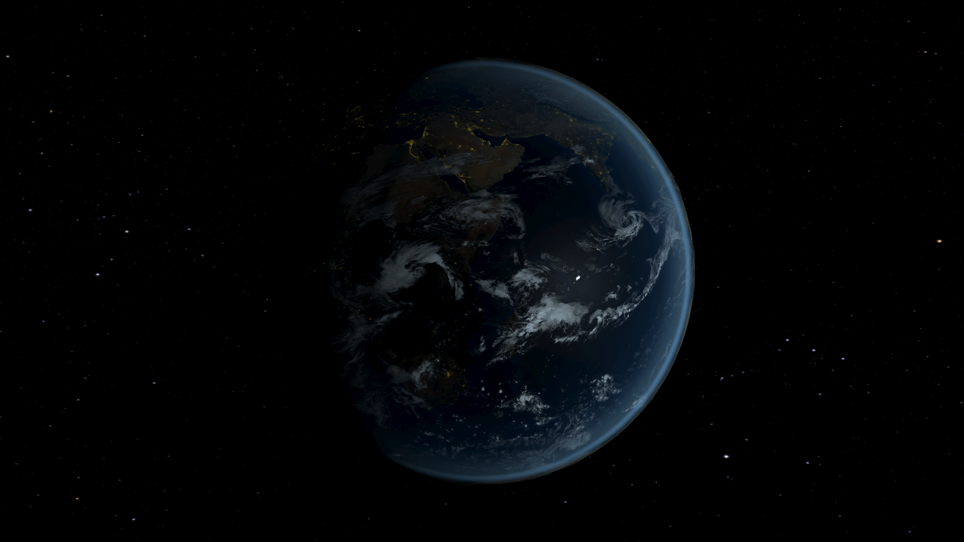

Elvissuperstar007
Posts: 2517
Location: Ukraine
self - illum
add need item light. which only shines in the dark. to display glowing cities
i don't use Planetary Environment, this is geometries for a certain animation, and my cities shine through on the day side
