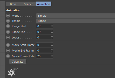

Ahh thats great about the 'Complex' and then being able to assign numerous 'Values'. I don't think it will need to be as complex as you have it as I can go to the animation tab on the image sequence and offset each value range by 5 (that part will be a bit manual) but essentially that should all ready cleanly from the one folder and as long as it doesn't crash reading soo many sequences then this should do the trick.
I'll let you know how I go.
Thanks,
Dean
Thanks,
Dean
