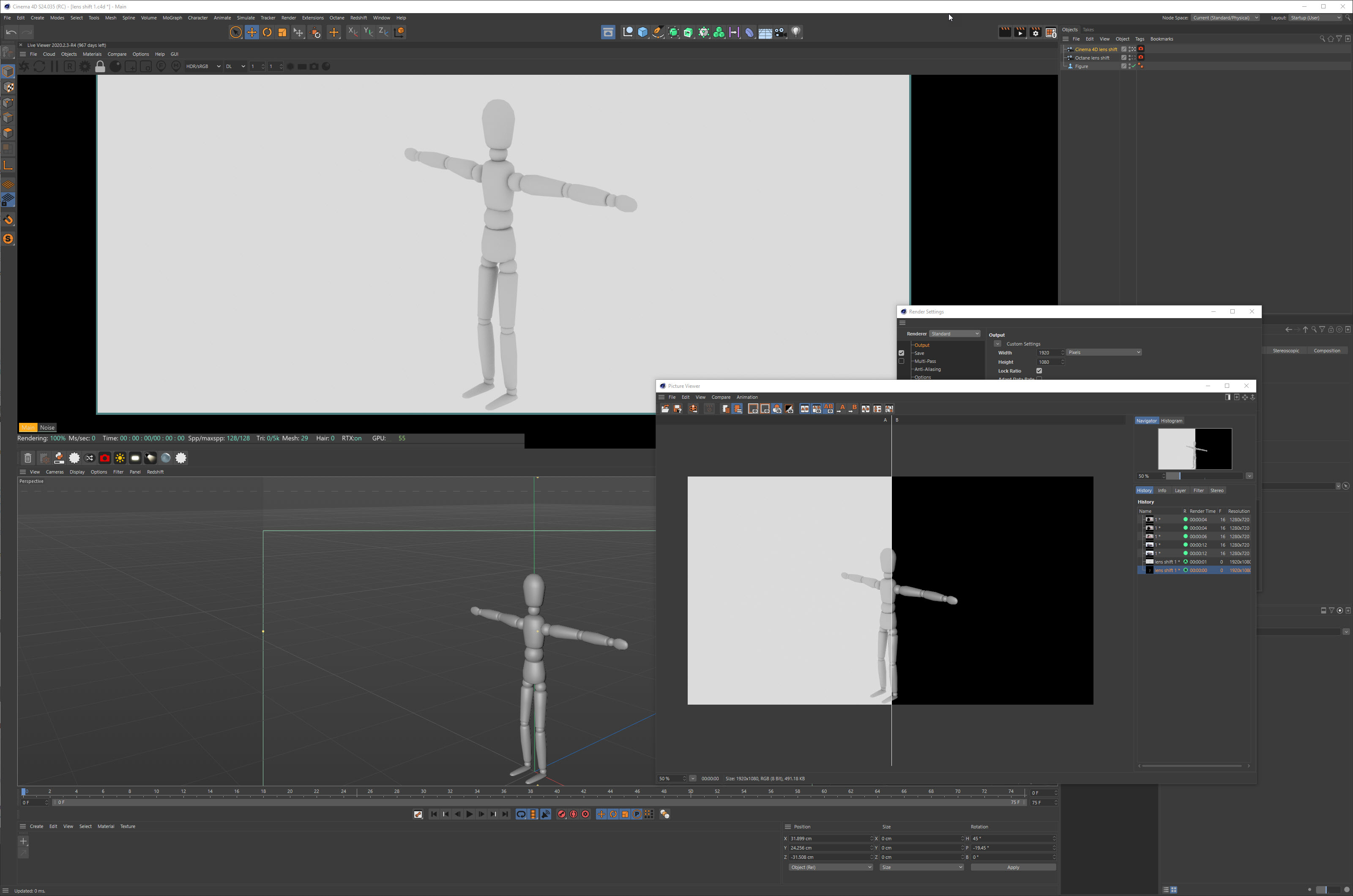

Screenshot example also attached, you can see the figure's feet sinking below the render frame when they're fine in the opengl view.

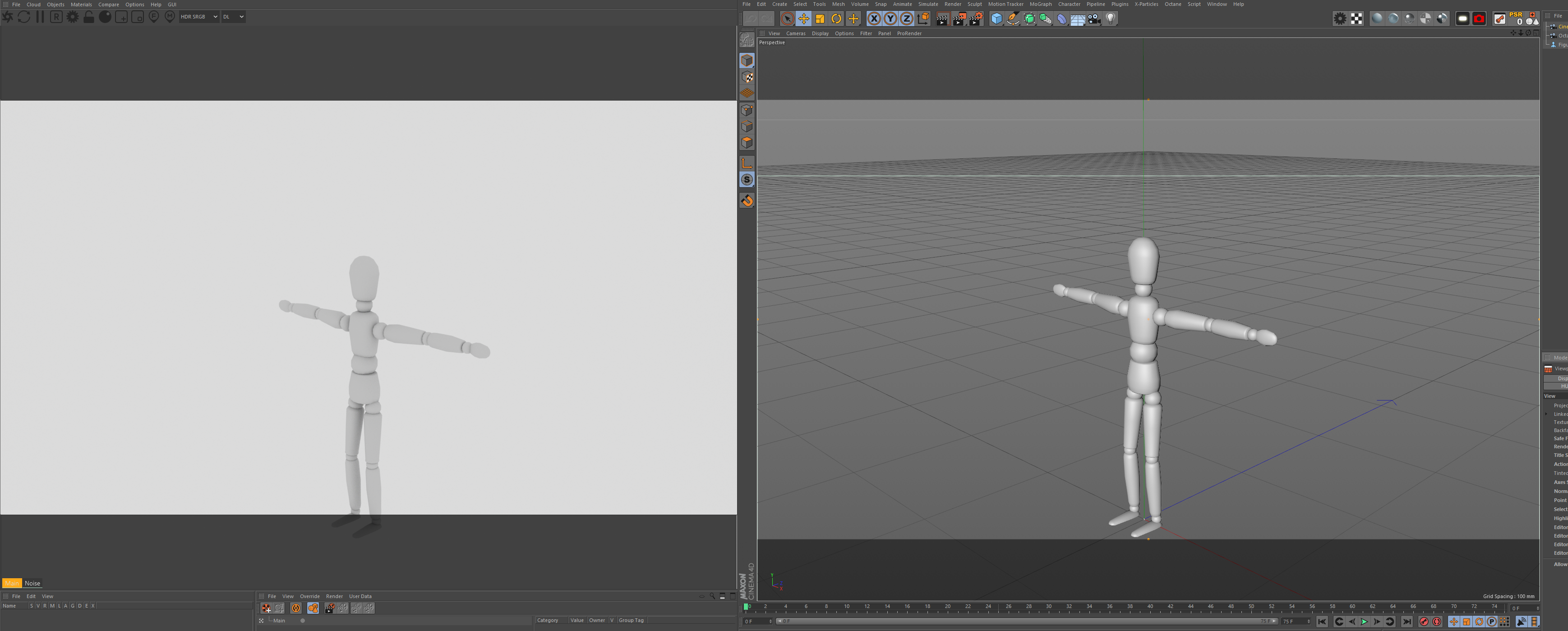

Yes there's a problem without LOCKRES mode, but it's working FINE with LOCKRES mode. See my comparison, what do you say?
I'm not sure what you mean with trying to match or rendering unnecessary pixels. As you see it's perfectly same with standard renderer.

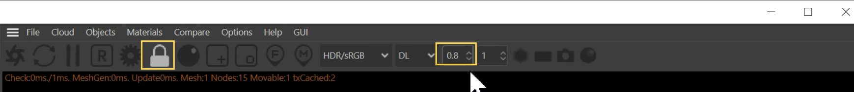

There's a CANVAS SCALE and also RESOLUTION FACTOR settings in Live viewer. Use it!boxfx wrote:My live view window is roughly 1000x700 pixels.
