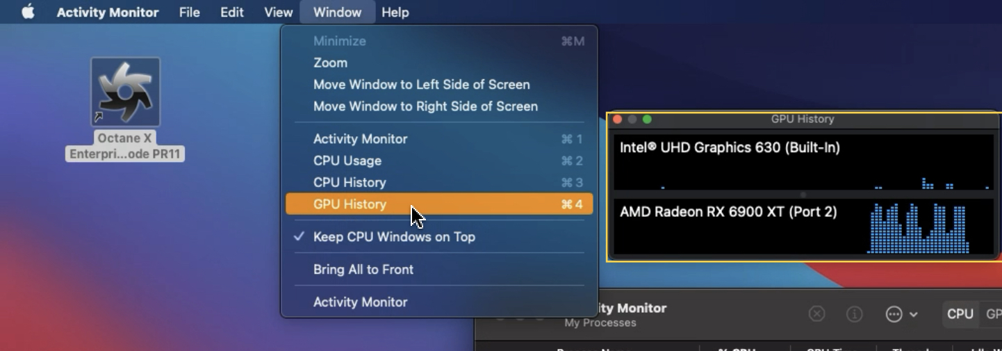

Posts: 10654
Forgot to say that, you can go to /Applications/Utilities/Activity Monitor, run it, then go to menu Window/GPU History, to see the activity of th GPUs while working in Live View:
ciao Beppe

bepeg4d wrote:Forgot to say that, you can go to /Applications/Utilities/Activity Monitor, run it, then go to menu Window/GPU History, to see the activity of th GPUs while working in Live View:
ciao Beppe
Many many thanks. Totally solved. I had no idea what these settings were and since Redshift seemed to work well out of the box I assumed there was a problem. Very well explained and the Activity monitor tip is really useful. Again Beppe many thanks
