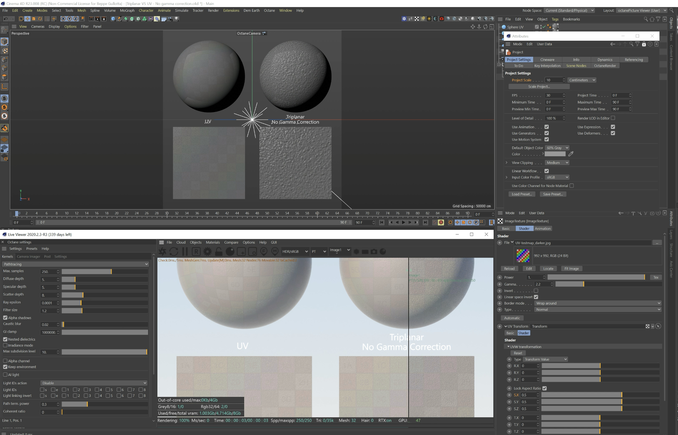

Whenever I have been using triplanar mapped bump maps I have always felt that there is something off, so I wanted to do a proper test.
I have set up two test scenes with two spheres and two planes, one of the planes and one of the spheres are using UV mapping, and the others are using triplanar mapping.
I used a UV test grid map to make sure the scale of the mapping is the same, and a simple image of some noise as bump.
When comparing the results, you can clearly see a huge difference in the bump map result. The UV mapped objects look as expected, but the triplanar mapped ones look very odd, rough and lacking highlights.

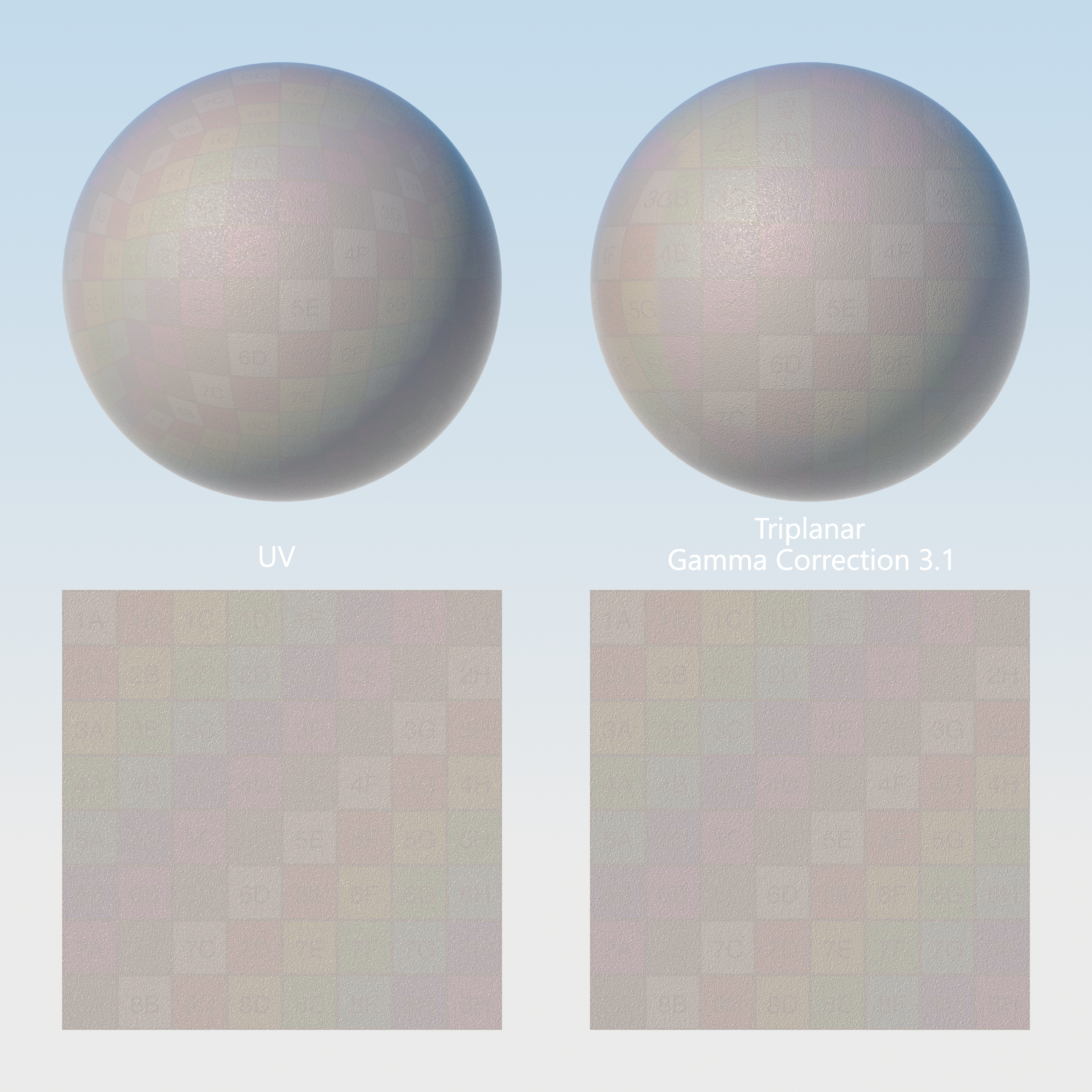

At first, I couldn't figure out why, but then I tried applying a Color Correction Node to the triplanar mapped image. With a gamma value of around 3.1, suddenly the result is looking more like the reference UV mapped noise.
Is this a bug, or intended result? The albedo map does not seem to be affected, as it looks the same regardless of mapping type.
Attaching renders and a ZIP with the test scenes.

Hi Andreas, the images cannot match, based upon the way you have it set up. The UV cube and sphere image maps are scaled at 1.0, but the Triplanar cube and sphere image maps are scaled at 0.05. That scaling is significant, and you will see some differences as a result. Your gamma correction attempts to resolve the differences, and that is a reasonable approach to take in this scenario.

Yes, you are correct that the triplanar texture is numerically significantly smaller scaled, but visually it's the same scale as the UV mapped material, as you can clearly tell from the colored checker map I used as scale reference.
Triplanar mapping set to a scale of 1 is huge, so to match the scale of the UV mapped object I have to scale down massively.
So my follow up question is, how should I be approaching this to avoid the rather unpredictable result from the neccessary downscaling and then needing to compensate with gamma correction?

Hi Andreas,
Jay's answer is more than wiser!
The Scale is crucial in Octane, and by default, it is designed to render at 100cm.
If you have a small object, and you also reduce a lot the scale, you go out of range for Octane.
Look at what happens if you change the Scale to 10, and the UV Transform to 0.5:
