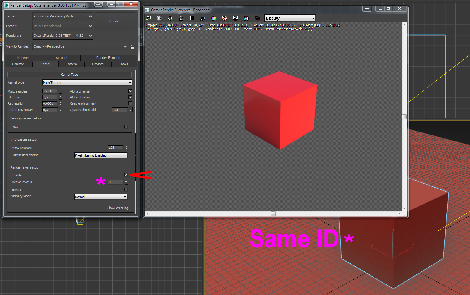

Hello, I want use cylindrical camera create VR, it need export 3 image sequences separately for sky, ground and architectures, but seems octane always keep render them in 1 image, how to render 3 images separately? Thank you!

After set layer and id(1,2,3), click render, the Octane only rendered id 3 object, how to render out id 1 and id 2 simultaneously? Thanks.
paride4331
Posts: 4002
Hi wesk,
you can render one ID at a time.
Regards
Paride
