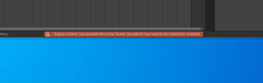

Just installed 2020.2_2.34 and having an issue with template start-up files.
If I switch to a different template, such as Sculpting, Octane Render no longer shows up as a rendering option. Opening another default template (General, VFX, 2D Animation) still prevents Octane Render from showing as an option. However, preferences clearly shows the plugin is enabled. I can only get access to the Octane Render option by closing Blender and restarting.
I have come across this issue once before in an older build. This time though the problem also seems to be preventing me from making an Octane start-up template. I created the Octane template the way I always have previously (configuring my Octane set-up windows and saving the startup.blend file over a copy of one of the other templates in a folder named Octane). When I open this new Octane start-up template I get the following error: “engine ‘octane’ not available for ‘Scene’ (an add-on may need to be installed or enabled). But of course when I check preferences Octane is already enabled. Restarting Blender returns access to the Octane render engine - until I try to load a one of the other start-up templates.

I'm not 100% sure on this, but I suspect that something has changed from when you first created the templates. You might have to re-create them to get it to work again.

Nothing changed on my end except installing the new 2020.2_23.4 version. In fact I am on a brand new machine and the only other version I had on it thus far I think was the previous 2020.2_23.1 and never even created an Octane template for that version. However, that previous version which I still have installed dose not exhibit either of my problems with 2020.2_23.4.
Not only can I seamlessly switch between the Blender templates and have Octane render show up as a render option, but I am also able to create a specific Octane template that works. It is only the latest version that is spitting out the errors. I even uninstalled and re-installed it but problem persists.

Yeah, sounds like a bug to me. Mostly I was thinking it would be a change in Blender itself, but this does not appear to be the case. I would test for you, but 23.4 crashes instantly in Linux when I turn on rendering. :(

We'll look into that. Right now just start with the General Template and switch to any workspace. It will work perfectly.

FIXES SINCE LAST RELEASE: Fixed the Octane initialization failure when switching to a new template
Thank you for fixing!
