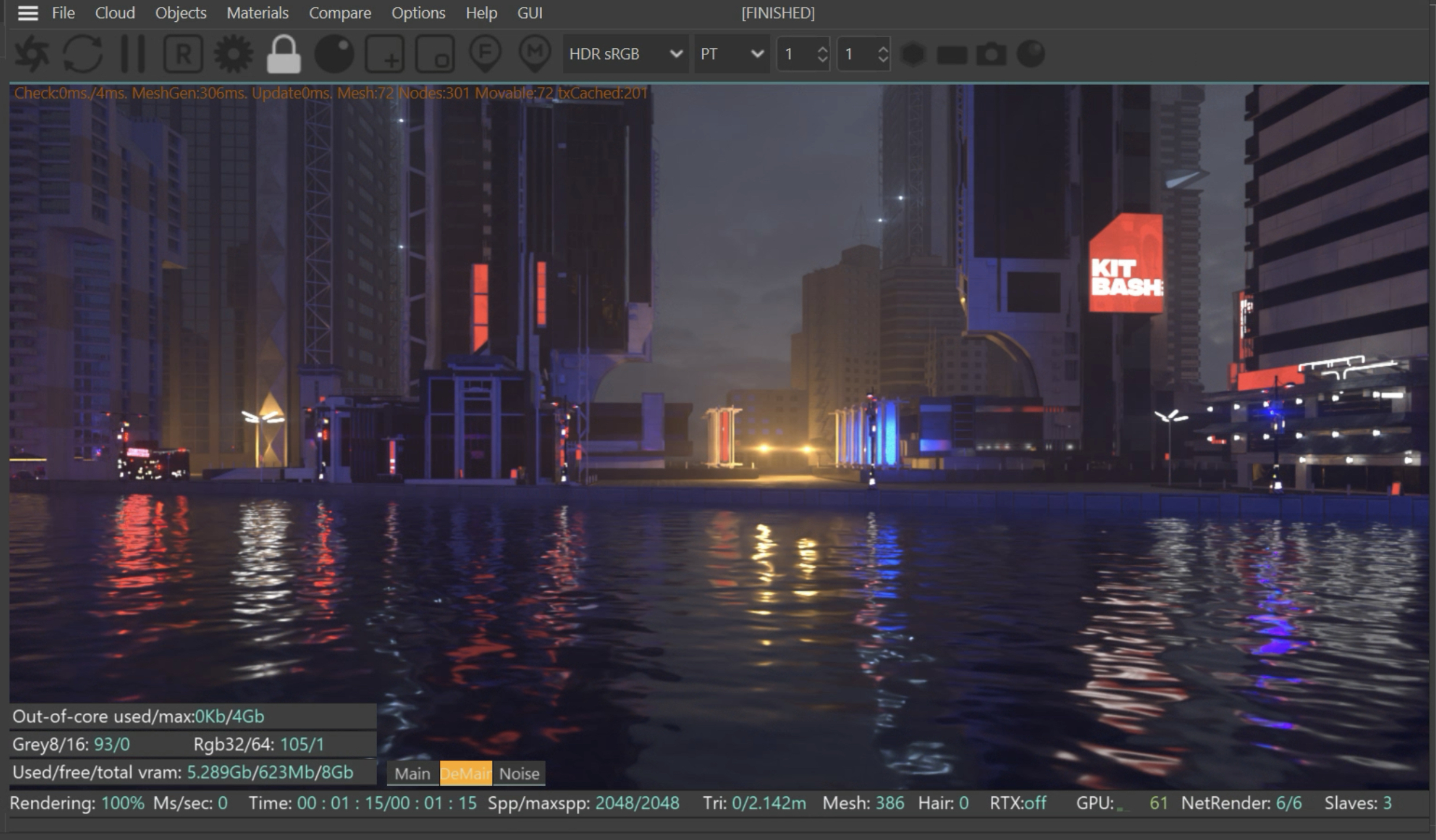

When using the node machines alongside it (three machines, each with a rtx3070) it takes about 1:14 per frame.
adding three rtx3070 to the rtx2080ti doesn't even cut the render time in half? That seems off...
Hardware monitors shows GPU usage from ~70-90%... but idk, 1:14 per frame still seems pretty slow...
what kind of network connection are you using between Workstation and Render-Nodes?
Everything is working as expected here with 2020.2.3 and Net Render, please have a look at this example with 10Gbit Ethernet:
- Workstation = ~400 OB = 3’:37” - Workstation (~400 OB) + 3x Render Nodes (~800 OB) = ~ 1200 OB = 1’:15”: ciao Beppe

I wonder... since I'm rendering several passes into an EXR, if that might be why its so slow? Because the farm nodes don't contribute to that, correct? So they are just chillin' there waiting for the main PC to send them their next frame?
I'll do some tests later today when I have time, and see what the difference is when rendering without those extra passes.
