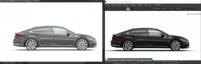

apparently I just stumbled upon the same problem. I wanted to re-render a scene from an old job today because I need some passes. When I created the job it was possible to save a tiff and a 32bit EXR via Team Render without any problems. The 32bit EXR is absolutely necessary, I work in a big advertising agency, our postproduction people need these passes mandatory. Half a year ago this was also possible, but now the result (left) looks totally washed out, before the results were the same.
So, what has changed there and is it possible to complete one tiff + 32bit passes in one render process? (These jobs are not just one car but 10-15, they have to render automatically overnight).
Thanks in advance.

Gleitfrosch wrote:+bump.. no answer?
Be sure you checked the save image, don't compare it from picture viewer. Its color management that's giving wrong impressions. Also be sure you set correct colorspace, now you can't choose different colorspaces for passes and beauty
