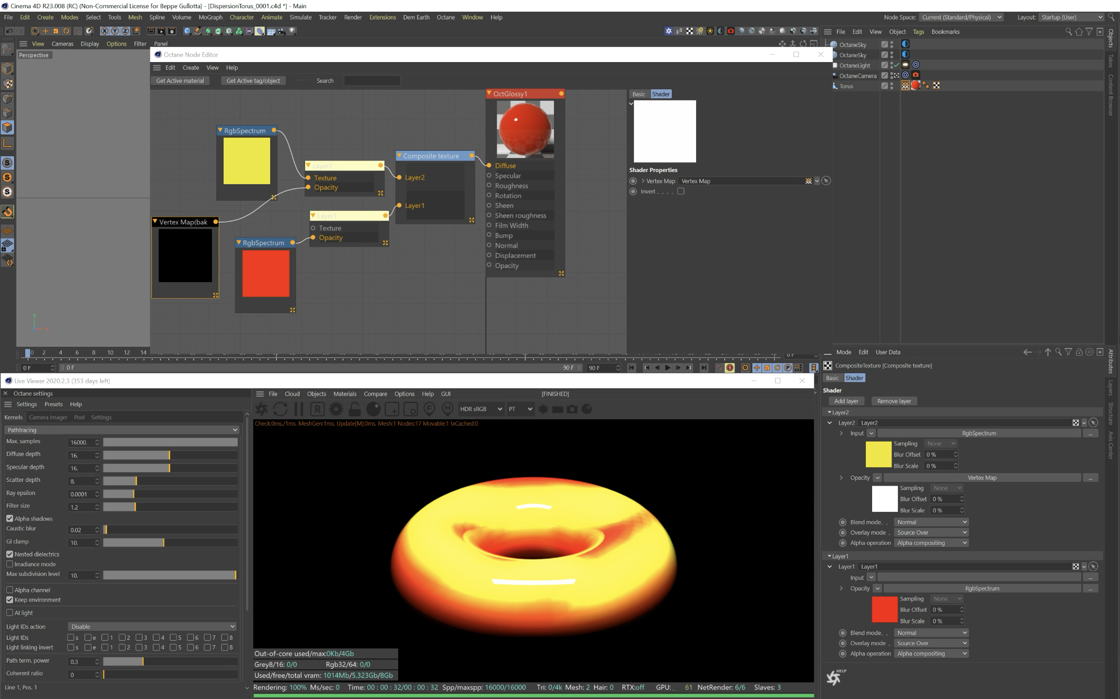

we have already solved the issue via support ticket, there are several c4d Layer shader in the scene so it cannot be sent to the Render-Nodes.
From 2020.2, the c4d Layer shader can be replaced with the new Composite texture node:
Happy GPU rendering,
