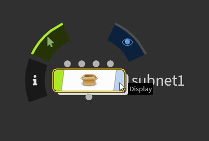

You can hide the whole subnet including all the inside objects if you disable the display flag in the node. Only be aware that currently this is not live updated in the IPR, so you need to reload the scene after changing the flag.
Hope it helps,
-Juanjo
