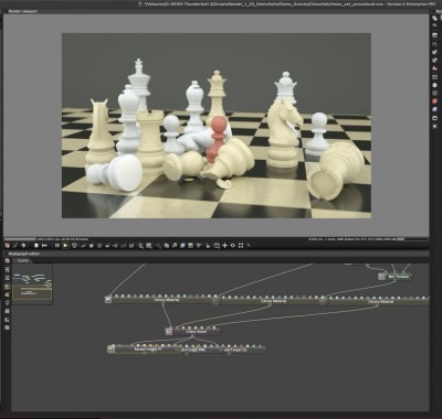

To test your GPU, please download and install Standalone OctaneX from App Store, open it, right click anywhere in the node graph panel, and choose Materials/Metallic, to create the material node.
Now right click on the node and choose Render.
Then please share a screenshot of the Standalone interface thanks.
If you see the Material Ball scene, everything is working correctly.
Then please download the simple example scenes package:
http://render.otoy.com/downloads/Octane ... oSuite.zip
Then open in Standalone PR7 the chess_set_procedural.ocs scene, then click on the Render Target PT node, and share a screenshot, here is the result of my AMD Radeon Pro 575 4GB:
ciao Beppe
