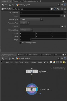

You need to create a UV map in SOP or use a projection node.
