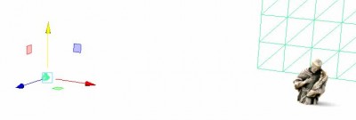

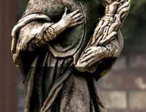

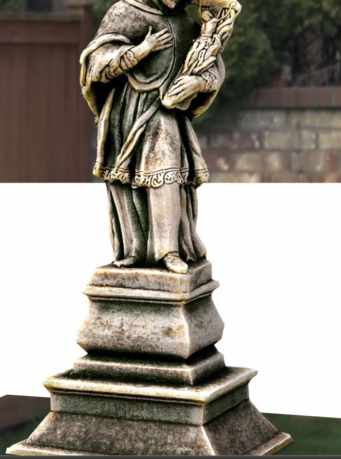

I'm getting this line running horizontally through my FBX object. It's noticeably darker below this line. I think it's part of the Aperture setting. It doesn't show on the wall image plane I have in the background. It only shows on the geometry rendered from my FBX object.
In the top photo attached, I see this line when the Thin Lens Camera Aperture is set to 0.200. The bottom picture is when the Aperture setting is set to 0.00. I can't seem to change the Aperture edge to anything but the default 1.0.
Any ideas of what causes this line?
Thanks,
Jeff
Aperture set to 0.2
Aperture set to 0.2
Aperture set to 0.0
Aperture set to 0.0

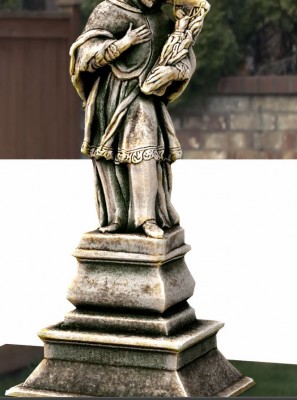

I have the reason this line shows up. It has to do with the height of the camera which moves the image plane. When I moved the camera down to below the base of the statue, the line went away.

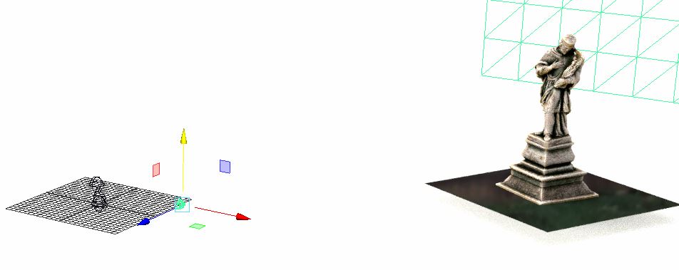

My question now is, what is this white barrier? I can't select it or add any materials to it.
Line goes away when the camera is moved down.
Before, when the line rendered

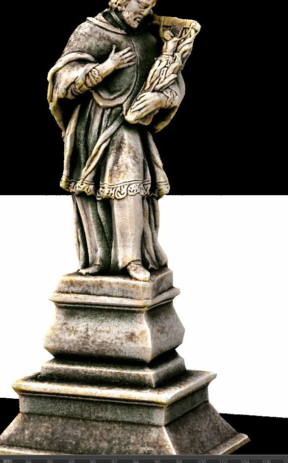

Also this white barrier doesn't allow me to render the HDRI environment or the image plane. Checking or unchecking the Kernel Alpha channel doesn't help.
Thanks,
Jeff
With Kernel Alpha channel checked
When Kernel Alpha channel is not checked.

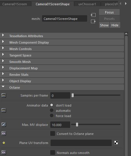

I learned what was causing this mysterious white plane is. I had checked "Convert to Octane plane". Turned it off and it went away. Had to change the Image Plane to an Octane material manually.
