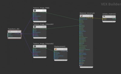

With further working I realized one more thing - the Transform updates for materials if it's connected to a Displacement node and it doesn't if it isn't. I guess that Displacement node triggers the update in this case.

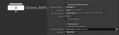

How to setup ACES in Octane for Houdini?
Arnold and Redshift renders recognize ACES and it's view transforms by setting up OCIO variable inside houdini.env or package.

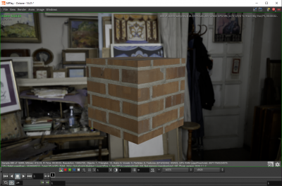

What is step by step process for octane? I tried to connect Ocio View node with ACES - sRGB transform to Camera Imager and select ACES as Intermediate Color Space, but result is not correct.
The same goes to Mplay render as well

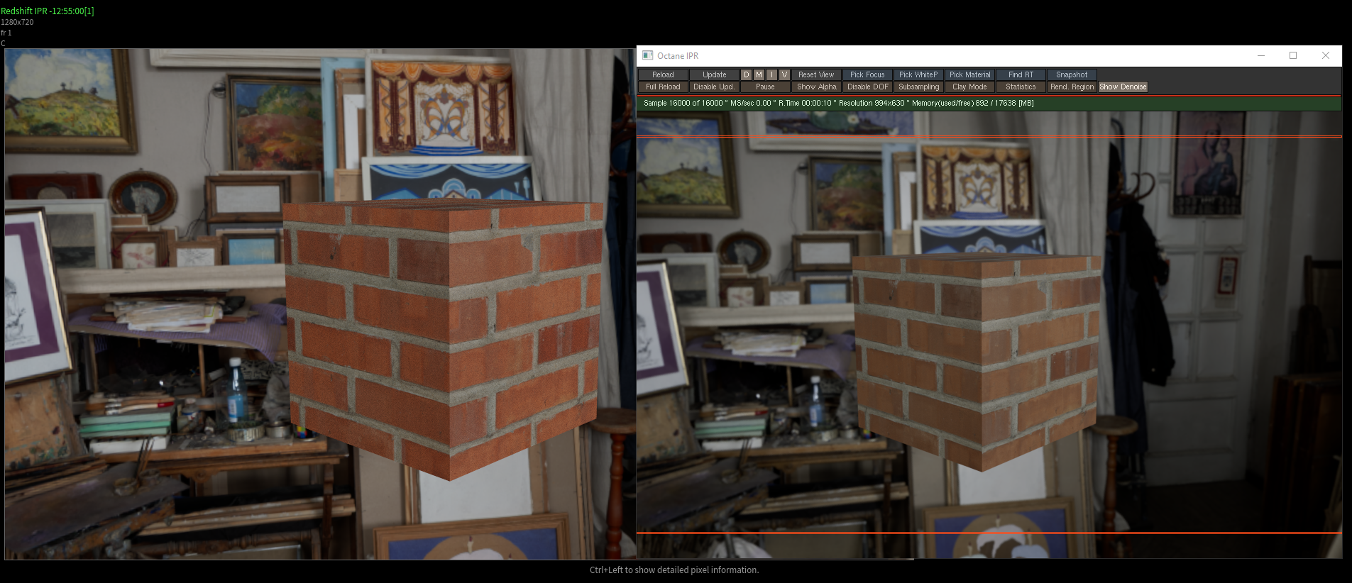

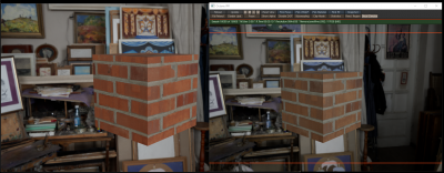

The brick texture and the HDRI are converted to ACES in Nuke. Arnold and Redshift give identical colors, so everything is working right. But Octane produces completely off results
PFA examples of Arnold and Redshift comparison to Octane

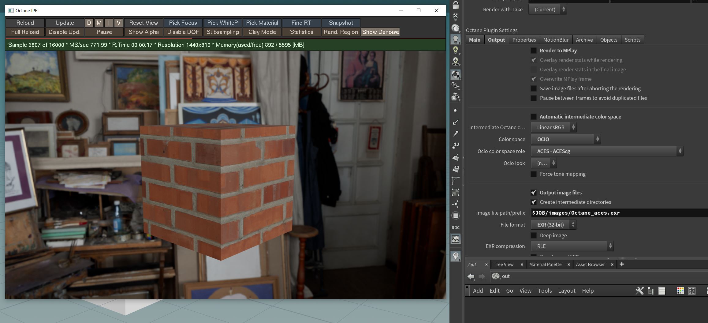

Have you tried to configure the "Intermediate Octane color space" as "Linear sRGB" after disabling the automatic intermediate color space? This seems to match more the renderings of the other engines.
Thanks,
