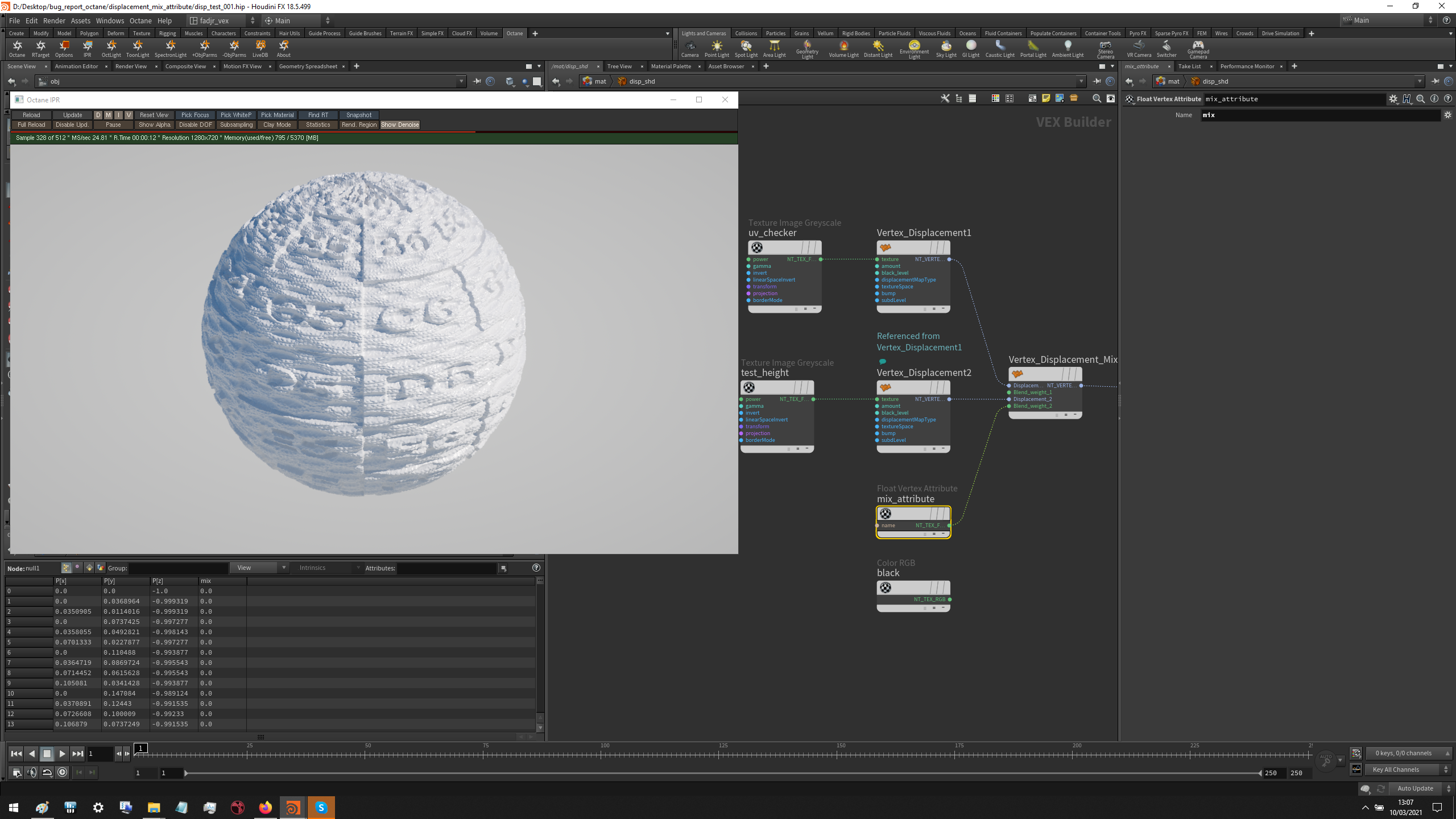

I'm trying to use a float vertex attribute to mix 2 vertex displacements, but when the attribute is 0.0 I can still see the second displacement, where I should only see the first.It works fine when using a rgb colour node set to black.
Any idea what that could be from?

Yes, this is currently a limitation. We are probably going to solve it in the future, but that requires a good amount of work we didn't have time for yet.
