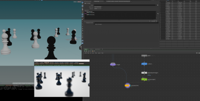

I've instance a few pawns each with one color (one white one black), I've made a material with "rgb4k_map.ppm", but all pawns are black ?
Any idea please ?
My scene https://www.dropbox.com/t/bqVAwuoD0VtGXLah

Hmm, here your scene seems to work fine. Are you sure that you have the right .ppm texture in your texture instance node? In your scene, it seems to point to my plugin textures directory!
Thanks,
-Juanjo

juanjgon wrote:Hmm, here your scene seems to work fine. Are you sure that you have the right .ppm texture in your texture instance node? In your scene, it seems to point to my plugin textures directory!
Thanks,
-Juanjo
ouch you're right the path was wrong, I'm really sorry
