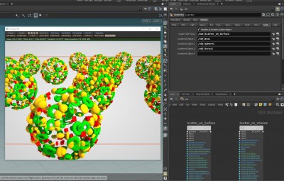

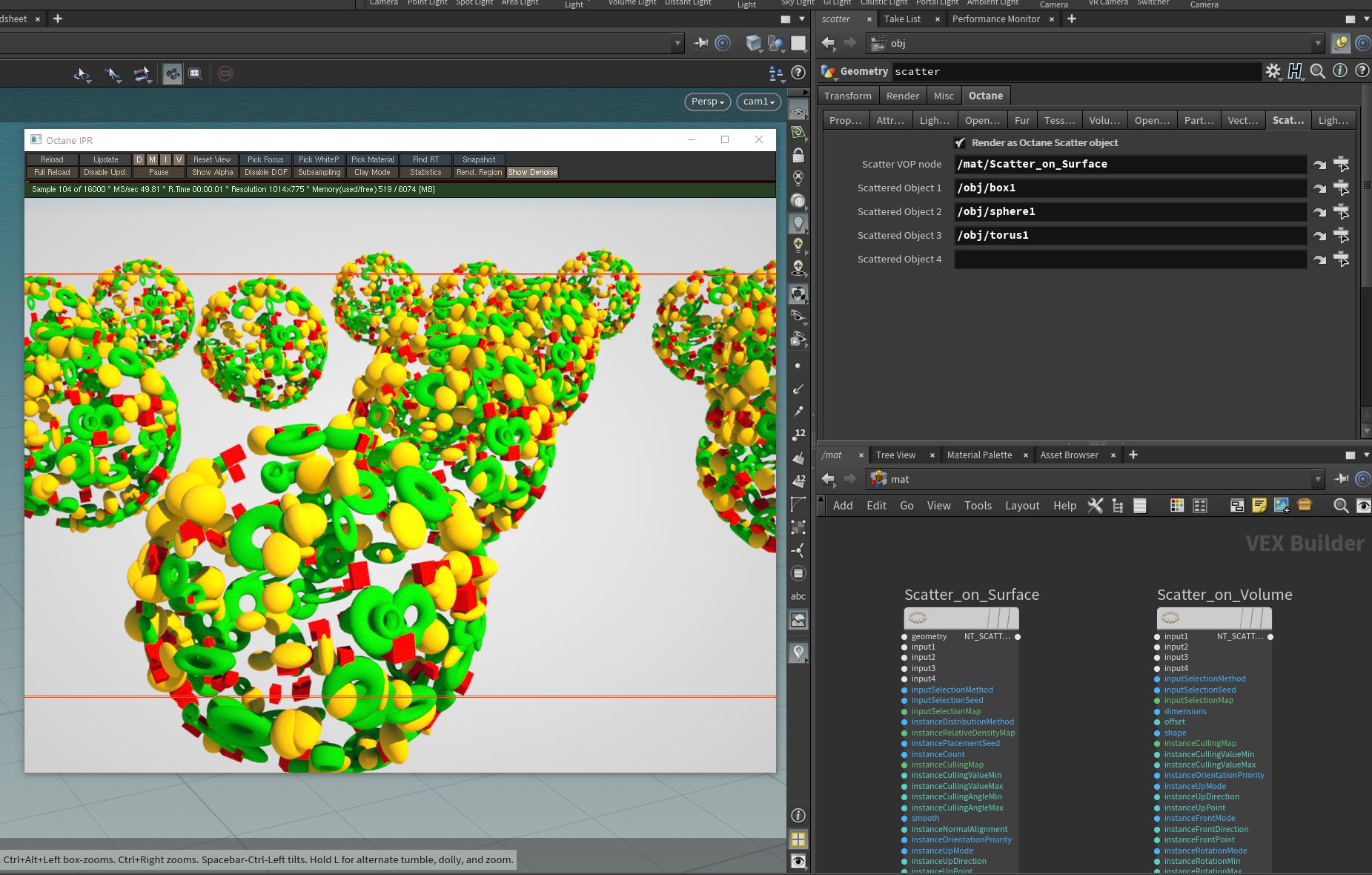

It is easy. You only need to enable the "Render as Octane Scatter Object" option and configure a scatter VOP node (that will be used to configure the scattering) and the objects to be instanced (4 max.). You can instance on surface or on volume. You can even instance these scatter objects.
Attached you have an example scene. Hope it helps.
