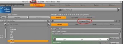

I hope you managed to get it to show. In case it is still not showing, from the Octane Pane go to the Materials Tab and then select any surface in the middle panel (Scene Surfaces) and click the Nodegraph Editor on the right hand side panel (Quick Edit).
