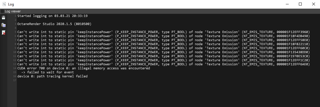

My system keeps crashing, mostly when using the live viewer. Here are my specs:
Octane 2020.1.5-R4
GeForce Game Ready Driver 456.71
Windows 10
32 Gigs of rame
i7 CPU
See attached screenshot.
Please note, the crashing just started happening. I've been using my system with no issues.

which version of Win 10 do you have?
You need to have 2004 or greater to have no issues with recent Nvidia driver versions.
Please also make sure to have performed a clean install of the latest Nvidia Studio driver.

Hi Bepeg4d,
My windows x pro version 19041.804
I have to keep my system at certain specs in order for all my hardware to run compatibly. Can you tell me which version of octane will allow me to use both of my graphics cards?
I have the following. At one point i was running octane with both GPU's perfectly but then i upgraded at some point. I would like to get back to the version where i was running both cards on my system. Please note, i only need the GTX for rendering.

Mixing Quadro and GeForce is not easy, since you should need to install a proper Quadro driver on the K4000, and the same Studio driver version on the GTX 1070
