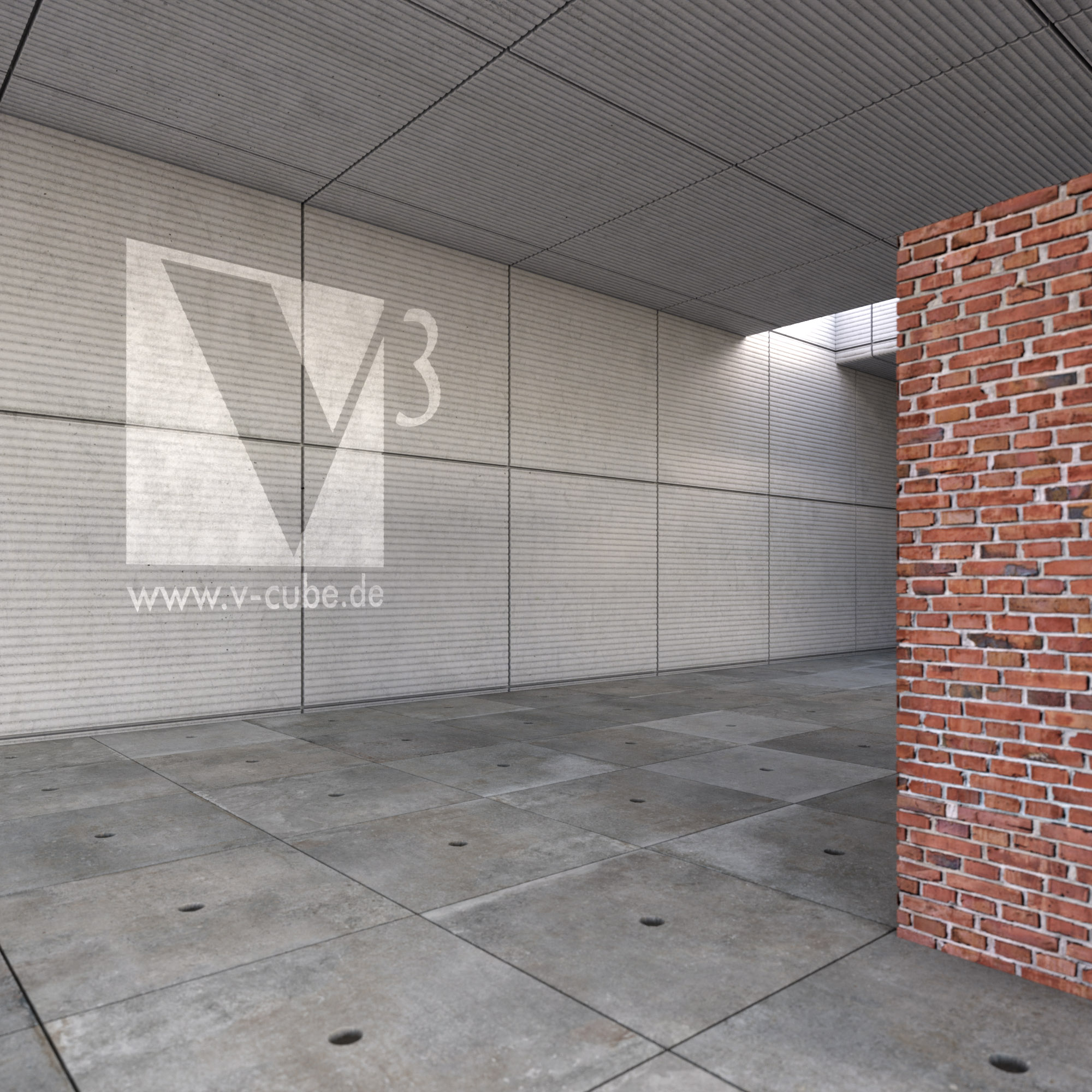

this is just a test scene, where I tried out OSL scripts for multi textures, chaos node, combining different displacement maps and decal placement... works pretty neat I have to say...
