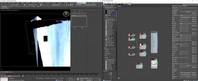

I have 2 questions:
1. Why can't I see the albedo textures in the 3Ds Max viewport? How can I enable show realistic materials with maps with an octane universal material?
2. I placed an HDR image to "Texture Environment" node and placed it at Environment Map. The HDRI image displayed correctly in Octane viewport - however the HDR image looks "rotated" in the 3Ds Max viewport. How could I resolve it?
3Ds Max version: 2020
Octane plugin version: 2020.2
You can download the Max file with textures to test it out:
https://drive.google.com/file/d/1Qe1XuA ... sp=sharing

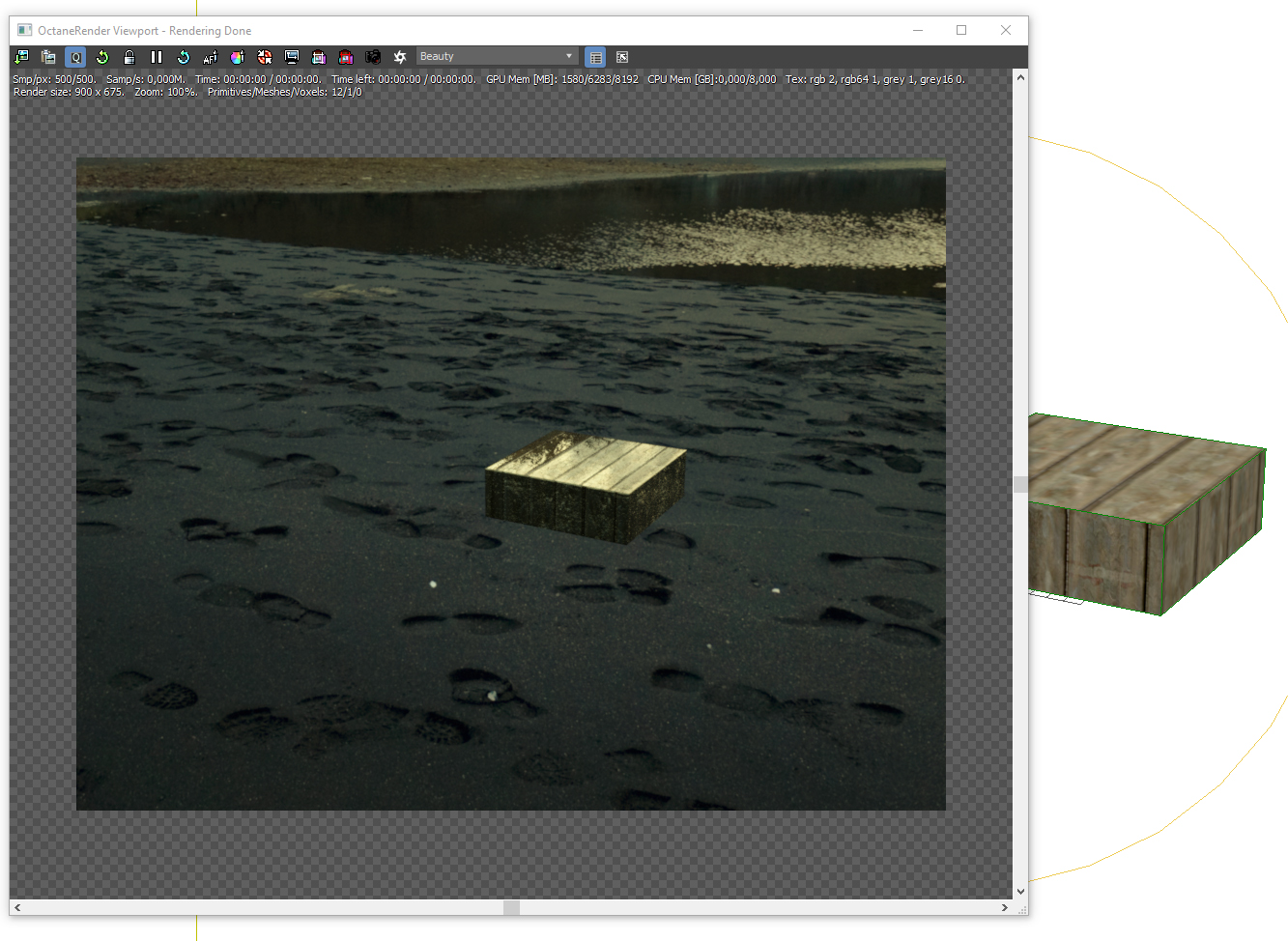

paride4331
Posts: 3991
Hi efforce,
I don't know what you did in your file.
About the environment I will report the issue.
Regards
Paride

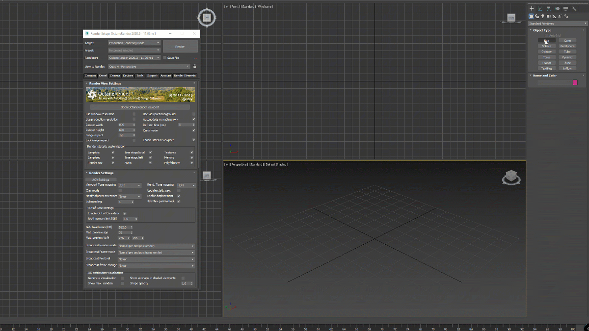

Could you please let me know how to you enable show maps in 3Ds Max viewport? Thanks.
paride4331
Posts: 3991
Hi efforce,
nothing special, pressing "show shaded material in viewport" icon.
Regards
Paride
efforce
Posts: 30
Joined: Mon Nov 19, 2018 7:30 am
Hi Paride, thank you for your demonstration!
Everything works now.
Cheers.
