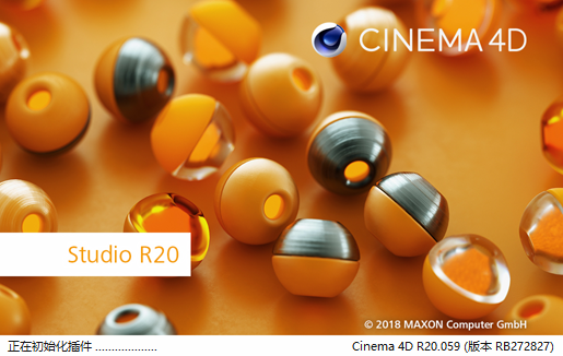

C4D R20 059 & OCTANE V4.05-R7
Stuck in the initial reading interface
bleeckerj
Posts: 2
Joined: Sat Feb 20, 2021 7:46 pm
I have the exact same issue. Doesn't seem like anyone has commented to point out what the problem may be. I installed Octane as per the instructions..but this issue recurs.
bleeckerj
Posts: 2
I sorted the issue by removing the libraries that corresponded to other version of C4D. As near as I can tell, this is not part of the documented installation procedures.
Posts: 10651
please, navigate to `C:\programs\Maxon\Cinema 4D R20\corelibs` directory, and share a complete screenshot of the content, thanks.
ciao Beppe
Posts: 16068
Location: Türkiye
It mostly happen if you don't remove the unused octane dylib/cdl64/xdl64 files
